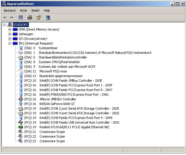

Each Scope Card has it's own IRQ (21,22,23 as i'm running in windows APIC mode now).
I have also tried STANDARD PC install, but the problem keeps comming up.

My Cards are not sharing IRQ's with anything... They are at 21,22,23 (see attachment)

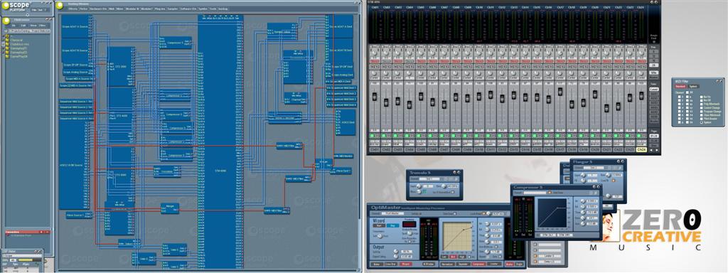

I've tried to freeze and unload all used VST's and it still keeps crashing.
I'm now gonna try what will happen when all STS samplers are removed from the project file (see other attachment)
This Project Hangs within 10 minutes (only when the sequence is running!)

I'm allmost sure now... The PC only Crashes with STS loaded.
That must be the reason why this project crashes a lot of times... Beacause there are three STS Samplers loaded... :-P
