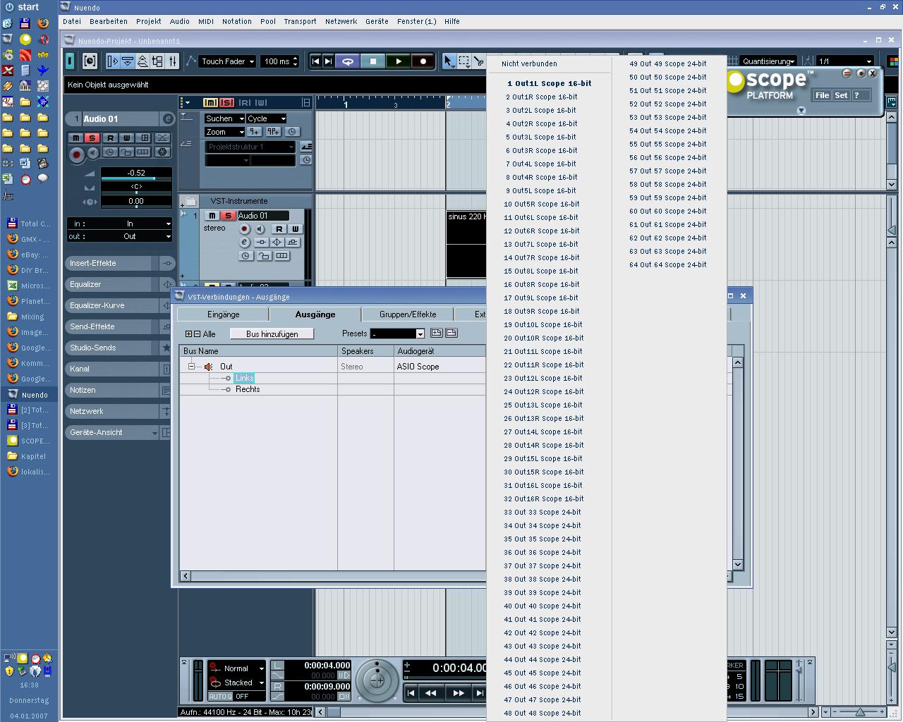

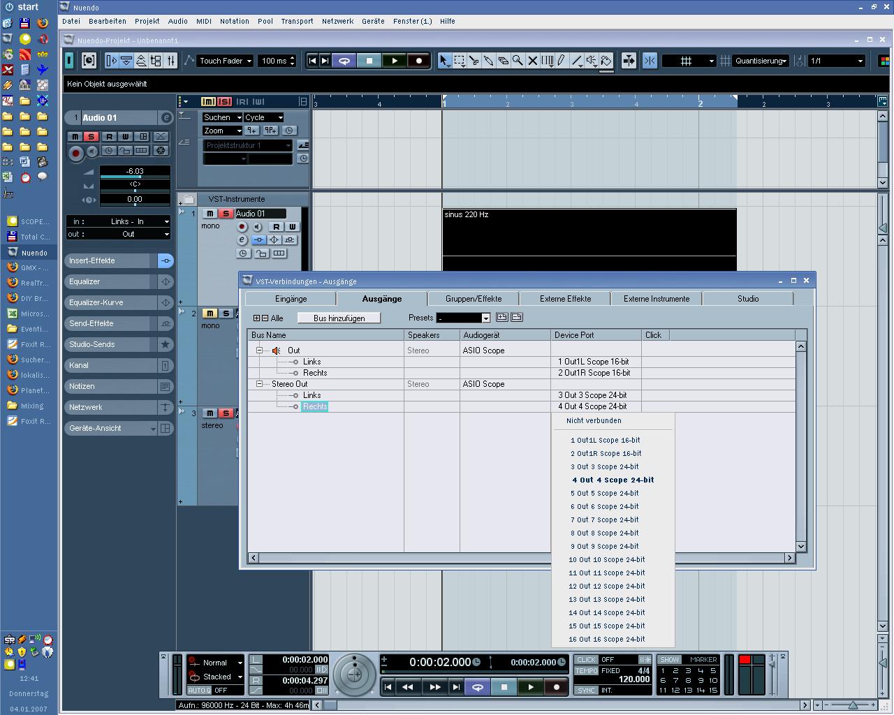

thanks mr arkadin, there´s something wierd going on...here some screenshots: (see attachment)
I found that the 6db boost only occurs, when I use the mysterious 2 supposed-to-be-16bit-channels, which neundo shows me as the first 2 output options...with the others everything shows normal! (I ignored that thing, as it made no difference, and seemed not really to output only 16bit - I thought it was some kind of graphical error...)
That thing is really weird, since I use the 24bit source and the 24bit destination Adio modules in SFP.
Ok, the quick workaround would be, not to use the first 2 channels, but that´s not a clean soulution, I´d prefer it worked better.
any ideas?
Tom
what the heck have 16 bit lost here if....JPG (206.33 KiB) Viewed 3152 times
...you look at this!.JPG (150.44 KiB) Viewed 3152 times
Mr Arkadin
Posts: 3283
Post by Mr Arkadin »
Huh, weird. i would maybe try re-initialising the In/Outs in Nuendo to see if it comes up as 16 bit again - i never got anything like that in the same menu in SX. Looks more like Nuendo is doing something weird than SCOPE. Also it's showing 1 as 1L and 2 as 1R which is also a bit odd ass they should be stereo pairs. BTW i assume that project is just for test purposes?

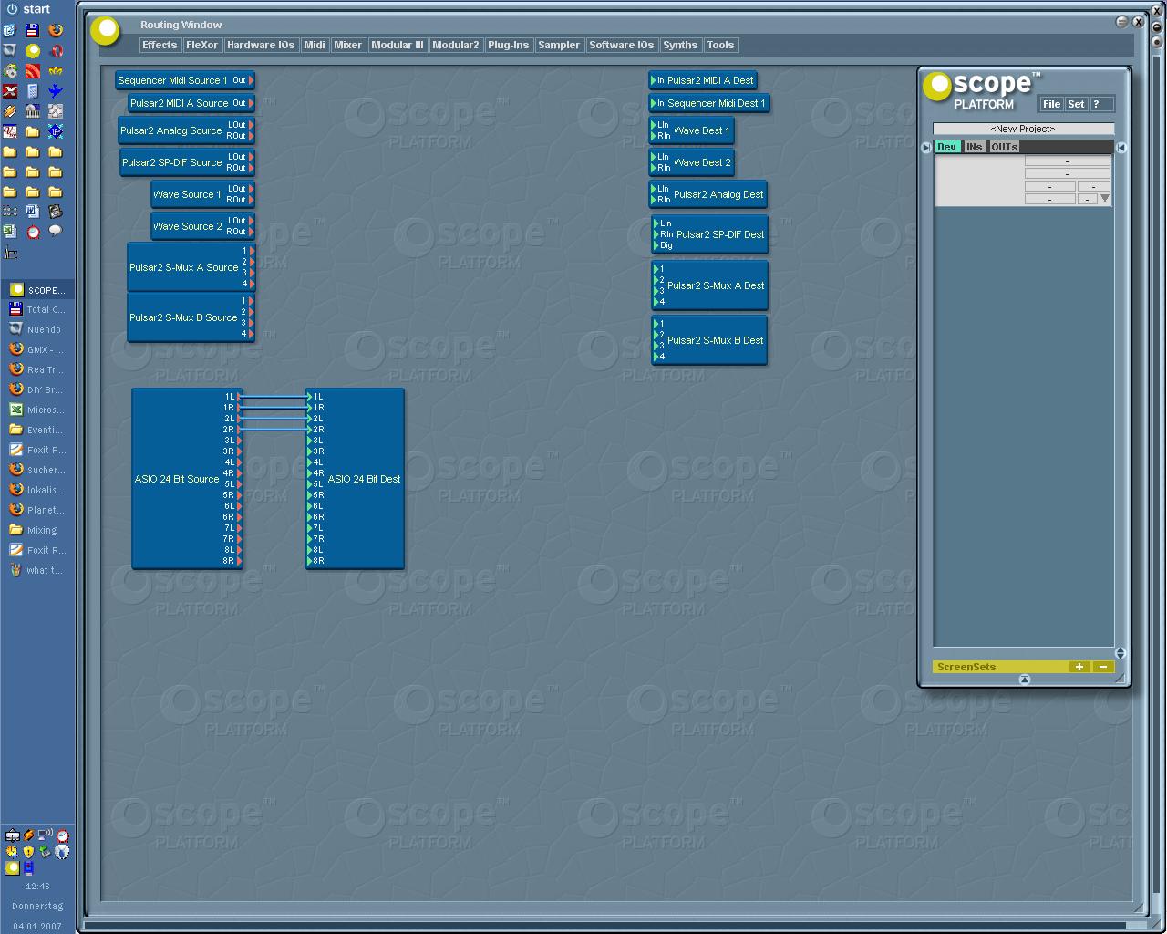

Asio1-32 flt source 64.JPG (226.93 KiB) Viewed 3119 times
