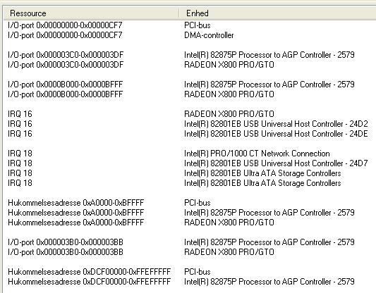

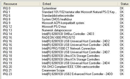

garyb : i dont got any IRQ share problem with Scope and usb
Pci Port 5(i think its there too lazy too open pc) is not supposed too share with anything , took some screens of it , my OS is in danish soo i hope u still understand it

- scope 1.JPG (43.22 KiB) Viewed 2994 times
- scope 2.JPG (59.22 KiB) Viewed 2994 times
