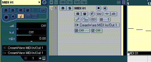

and in cubase
Cubase rout.GIF (19.7 KiB) Viewed 30024 times

Post by RobY_surf »
It doesn't work man..
Can you help me finding the problem?
Cubase showing that there is a sound, and still, not a sound..
See picture -
Thanks alot.
The module Pulsar Midi A source points to the hardware Midi input on your Pulsar card...
Use the Midi sequencer module instead to connect to Cubase.
You should study the manual for a while, it's explained very well.
Midi is not ASIO by the way, Midi is not 'sound'... (you say 'Cubase showing that there is a sound, and still, not a sound..').
SFP works just like an analog classic studio where you have to connect everything with cables, but
the thing as a whole is not a toy, so take the time to read the f. manual :-)

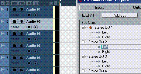

arela
Posts: 858
Location: Norway
Post by arela »
Something like this
All tracks are routed to  their own bus or to groups in Cubase
Cubase OUT.GIF (23.7 KiB) Viewed 29732 times
