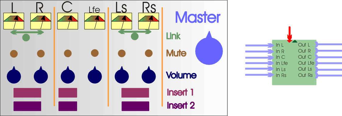

At last i draw this wonderfull device, but its a minus<br />.....it don't work !
Surround controller.gif (52.52 KiB) Viewed 4051 times

Think it might be better to ask for this device as a monitor controller.
What i want:
IN:
6 mono, 3 stereo or 2 stereo and 2 mono
all with mute button and volume
Optional - master volum
Out:
same as in
Forget insert slots and link buttons
The A Design ATTY2'D is what i want as a scope device,
please :-) :roll:
Surround Monitor Controller.JPG (16.88 KiB) Viewed 4022 times
Surround Monitor ControllerA.JPG (13.66 KiB) Viewed 4022 times

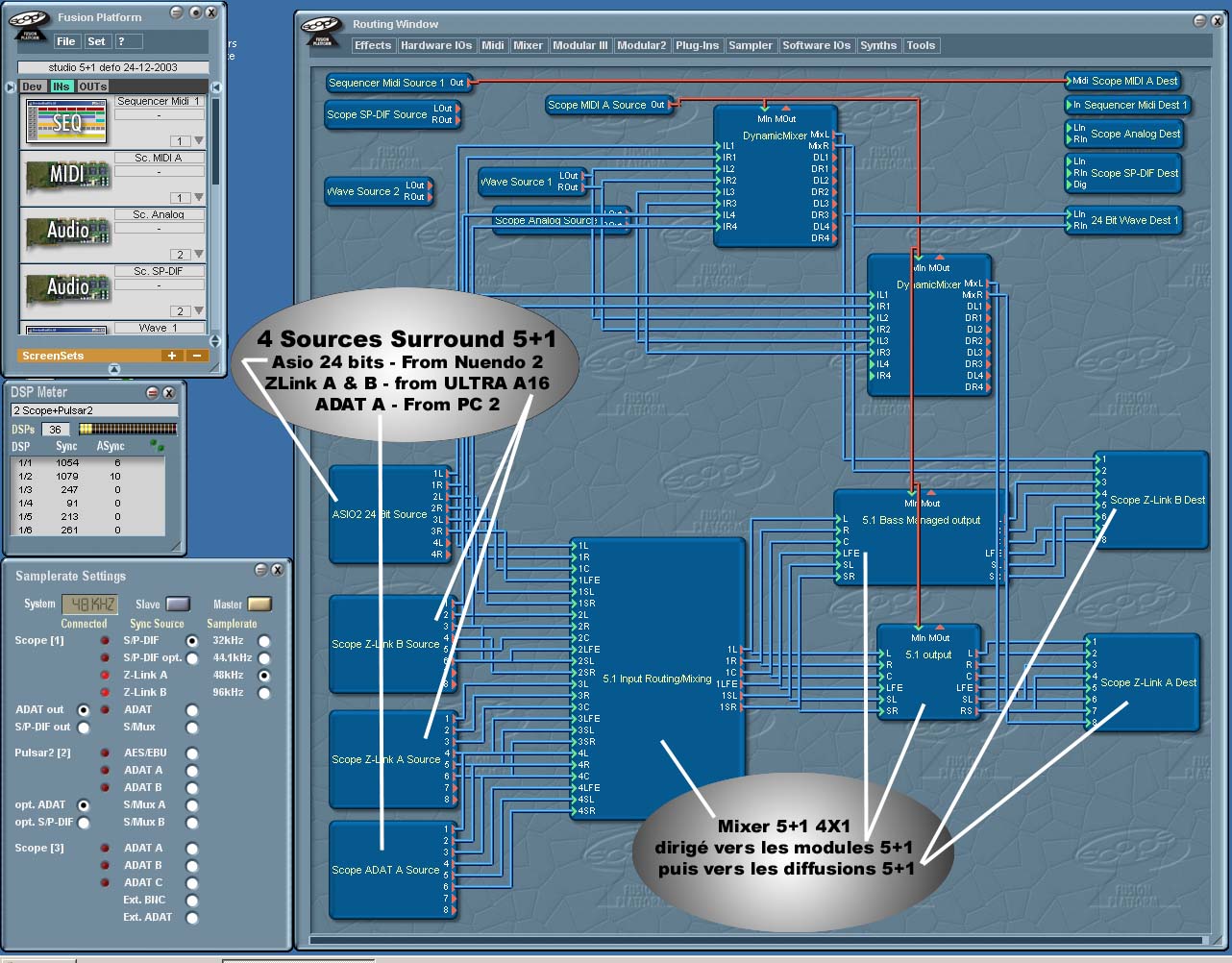

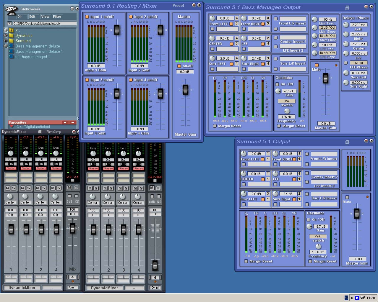

Post by sonolive »
hi arela ,
i have already build all you need, and more ...
have a look
cheers olive
routing window
routing window
projet studio 5+1 - stéréo.jpg (242.33 KiB) Viewed 3989 times
gui's
gui's
devices projet studio 5+1 - stéréo.jpg (271.25 KiB) Viewed 3990 times

hi olive
You're right, your Surround 5.1 Output
is what i was seeking.
In that way the topic was a little bit wrong :roll:
As it looks like Celmo would'ot upgrade his 5+1 Outputizer with midi controll, this device seems to fit my needs and demandings :-)

Posts: 561
Location: Digital AudioSoft
Post by sonolive »
hi arela,
these devices are very old and on the way to be optimised ...
will be sold as a bundle, in fact the most important of them is the Bass management, you will absolutely need one if you plan to work 5.1 ...
cheers
olive
