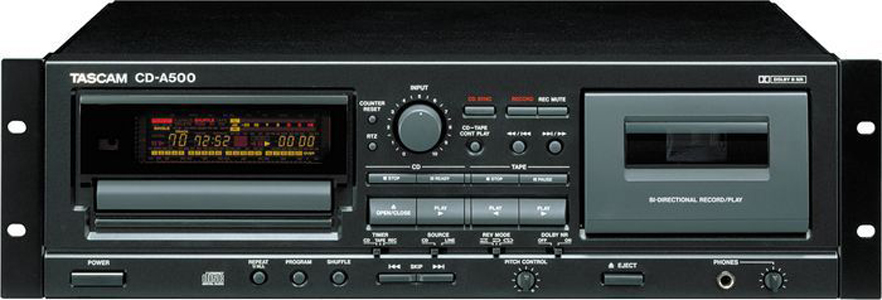

The real problem about XITE for live work as I see it is you still need to drag a PC around. You dont need a GUI or a PC to run a Yamaha QX1. But the QX1 is not rack mount, nor are most hardware MIDI sequencers (except some wierd doepffer stuff).
For rehearsals, only needing playback I used to create backing tracks on DAW at home, burn to CD then take 1 rack to rehearsal which contained mixer, preamp and rack mount CD player (with remote control). Then can also record rehearsal onto the cassette.
Rack mount CD players are good for this sort of thing. I never liked taking desktop stuff to rehearsals, just rack
Tascam Rack Mount CD
