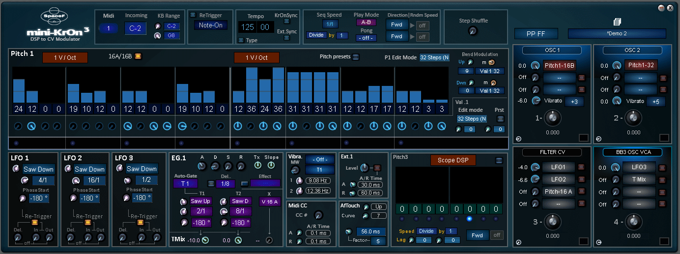

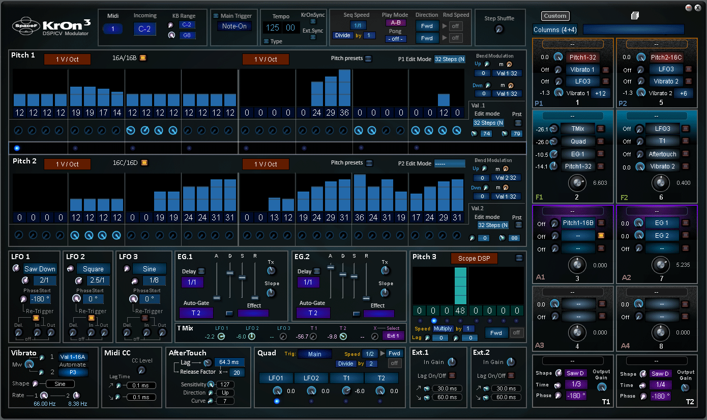

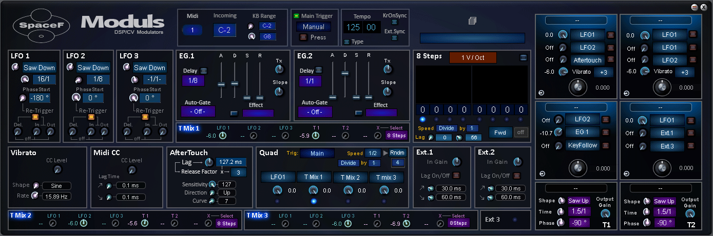

KrOn 3 is available for download in the user area.
---> Added Devices : Moduls and Pitch 64
---> BIg change in philosophy; the presets recall everything including the type of signal ( DSP or V/Oct or Hz/V). This means that presets made with KrOn 1 or 2 may show some weirdness, which is usually solved by choosing the right type of signal (ie DSP or V / Oct) and re-saving the preset.
From now on, the main device is KrOn 3 , with DSP and V/Oct only (as Korg themselves abandonned Hz/V). Hz/V is still available in KrOn 3 "max" and MIni KrOn.
Mini KrOn 3 is also available as a BB3 device (requires a BB3 activation key) @ 29 € instead of 49 € until end of october.
Please download from your user account. As usual, let me know if there is any issue dowwnloading the update (the zip name has been changed to reflect the date of the file).
with an xite, I can easily load each of the device below, in a single project. total = 16+4+4= 24 modulator outputs + 6 T1/T2 (T1/T2 are LFOs with their own output...which I did not remove because having those extra outputs prooved useful in several projects).
Moduls and Pitch 64 should allow to "re-create" a KrOn in 96 khz setup (let me know if not, I can remove a few stuff in Pitch 64 to make it lighter).

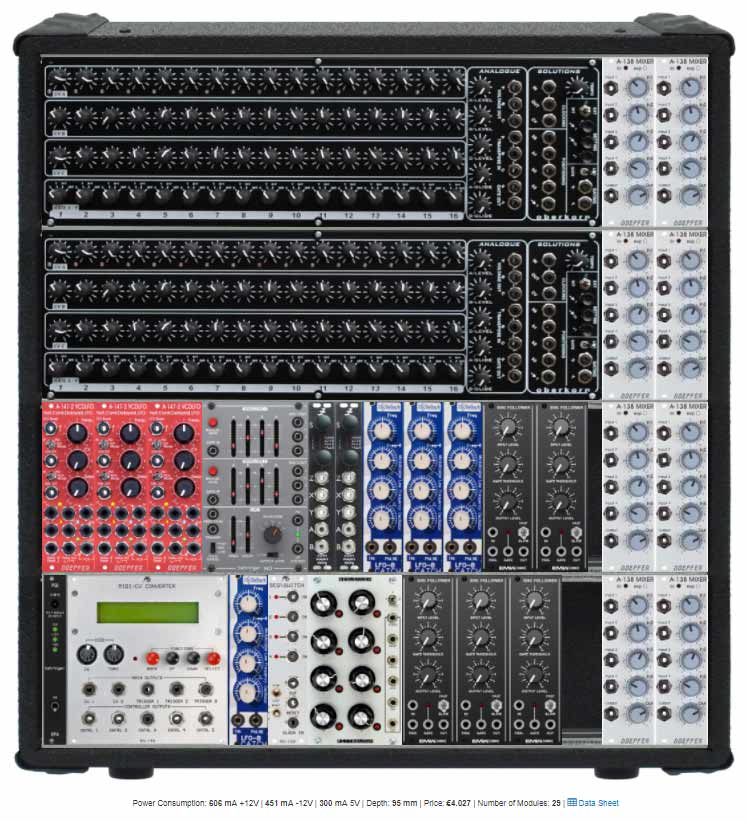

I tried to recreate KrOn on modulargrid website... 100 HP, 4000 euros (without the dozens of patch cables you would need) and it doesn't do DSP
missing a couple of envelope followers too... I guess you could get it cheaper with more behringer stuff, or simply not get it at all and save the price of an xite, lol
