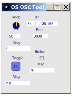

awesome give me 10 minutes ill post here my test tool and a conversion module for scope that takes the integers and converts them to int32 (what scope knobs usually like) :)
http://www.oceanswift.net

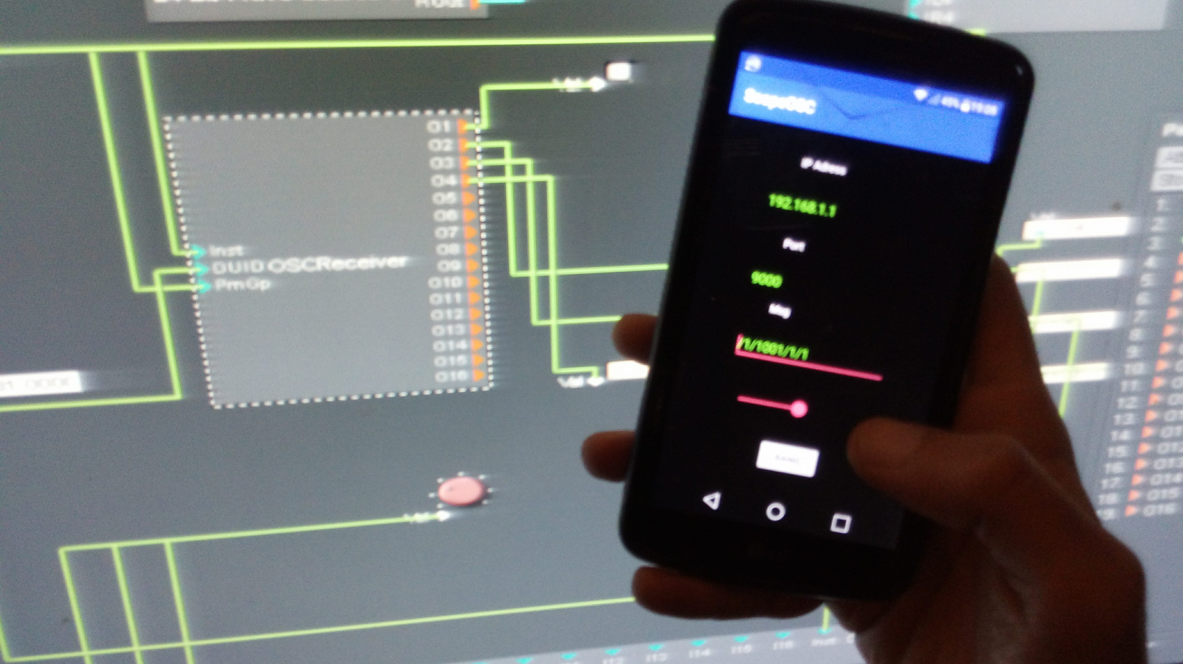

Big progress on android app, core technology is set up and working!

faxinadu
Posts: 1646
Location: israel
Re: OSC Receiver and Sender
Post by faxinadu »
https://play.google.com/store/apps/deta ... t.scopeosc
the scope side update is almost ready too :)
