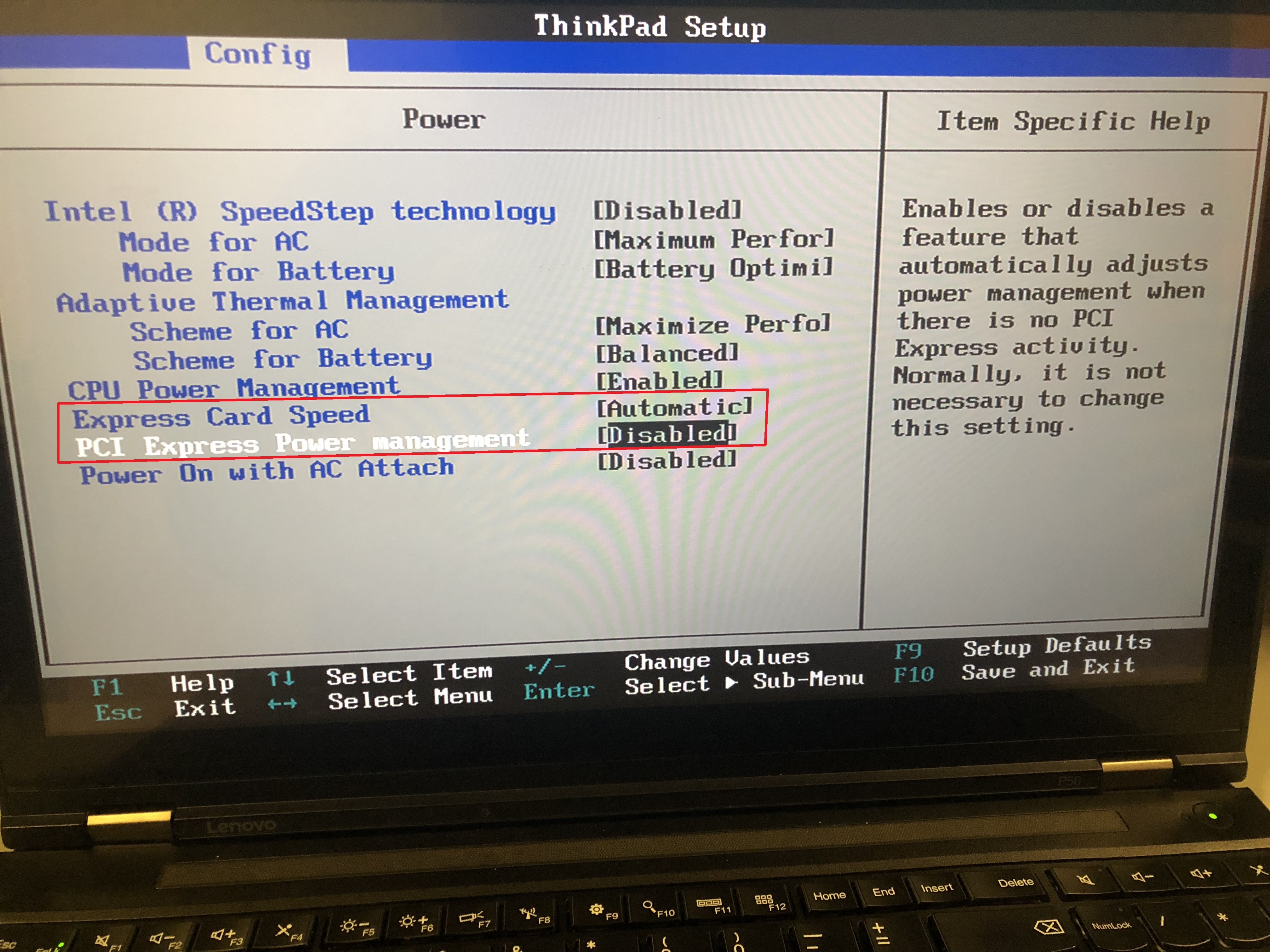

Hi. I know this is more than four years old but I hope you or anyone else with Mattomat working with Xite-1/Scope 7/Win10 64-bit can help.
It works perfectly here on my Win7 64-bit desktop, but not on my Win10 laptop, although I think i have tried all suggestions on this forum, including yours.
It just keeps freezing or BSOD’ing no matter what I do.
If you still have a working reference set of folders in a zip- file nomagic, I would love to try that.
Cheers
Re: Scope 7
Posted: Sun Dec 12, 2021 10:29 pm
by Liquid EDGE
Have you tried re installing all 64bit files for all your plugs that need it and reinstall the .sys files for mattomatt and then restart and reload scope. Load Mattomat, and if it crashes just try restart and load again…
I’m my experience having c350 and masterit screws everything up , if you had them and tried loading, they crash, but seemed to effect all other 64bit plugs and mattomatt!! (Luckily there are L versions of both those plug ins) those two plus das legend, need a file that windows 8 and above done something that stops that file working.
(If I loaded those two, all other 64bit reliant plug ins, & mattomatt kept crashing!!! Replacing the required 64bit files got them working untill I touched c350 or masterit again) and fir some reason mattomatt is effected too! 🤷‍♂️
I’ve got it working doing this. Everything works solidly now… though occasionally Mattomat crashes on first load… but then works after a restart most of the time..
Re: Scope 7
Posted: Mon Dec 13, 2021 2:43 am
by Xite Knight v2.0
Liquid EDGE wrote: Sun Dec 12, 2021 10:29 pm Have you tried re installing all 64bit files for all your plugs that need it and reinstall the .sys files for mattomatt and then restart and reload scope. Load Mattomat, and if it crashes just try restart and load again…
Thanks a lot for your input.
My short answer is yes. I have tried all that without any of my DAS stuff "interfering" (because it wasn't installed at all).
I have an image of a fresh Windows 10 installation on my laptop.
I have restored that fresh image countless times.
Each time, I have installed a fresh, vanilla Scope_v7.0.1705_x64_xite_english.exe
Then I have added (only) Mattomat in exactly the same way that worked on my Win7 64-bit statonary PC (I have of course also tried to add Mattomat in many other ways based on suggestions on this forum)
As mentioned, I have also tried nomagic's suggestions above.
Based on your input, I was now inspired to also try - after a Mattomat freeze/crash - to:
  • restart the laptop
  • reinstall the Scope_v7.0.1705_x64_xite_english.exe on top of the existing Program files\Scope Xite folder
  • add again the 2 Mattomat .sys files to the sys folder - basically owerwriting the 2 files that were already there
  • restarting both the laptop, Scope and Mattomat countless times
It never works. What happens is either:
  • the laptop just freezes without any visual feedback
  • the laptop just freezes with different visual feedback such as a) the Mattomat is visible in the routing window but frozen b) the Mattomat is visible in the routing window + the classic dialog box saying that 'a PCI capacity limit has been reached' - but everything frozen
  • the Win10 "version" of BSOD saying something like 'Sorry, your device ran into a problem and needs to restart. If you talk to a helpdesk college you can mention that the fault is: paging fault in non-paged area. What is causing the fault: tgsxmatt.sys'
When the laptop freezes, the only way to move on is to hold down the power button until the laptop shuts down.

Re: Scope 7
Posted: Mon Dec 13, 2021 3:26 am
by Liquid EDGE
Nightmare…
What is odd is that when I was sorting stuff out.
I was about to give up on Mattomat as every time I loaded it it would blue screen of death. But for some reason once I had successfully opened convolveq and other das plug ins and the Analyzer, I decided to give mattomatt another go, then magically worked…(again) blind trial and error luck. 🤷‍♂️ (Well not blind, a def pattern was emerging) as if a plug in pokes about with something that Mattomat also pokes at) and in my case it all got reset if I dared open c350 or Masteriteq.
Could just be a coincidence, I’m not a programmer, I’m a user. 😊 but the same patterns were happening, it was not random!
Load c350 everything crumbled… go to Mattomat first, crash….
Re install all files, install c350L & masteritL…
Successfully load up c350L, masteritL, convolveq, Analyzer, and then go to mattomat and it then successfully opened…
Re: Scope 7
Posted: Mon Dec 13, 2021 4:04 am
by Xite Knight v2.0
Liquid EDGE wrote: Mon Dec 13, 2021 3:26 am Nightmare…
NOT ANYMORE :D :lol: :D :lol:
IT WORKS!!!!!
I was just about to give up, but based on the rare PCI capacity limit reached message, I started to monkey around in the bios. I changed the two parameters inside the red box below:
  • Express card speed from 'Generation 1' back to 'Automatic' (default)
  • PCI Express Power management from 'Enabled' (default) to 'Disabled'
So one of those two should be the culprit, in case anyone gets the same problem in the future.
There's no way that I'm going to test which one would get me back in trouble again :D
My C-drive is now image backed up - case closed and back to actually using Scope :lol:
Thanks to Liquid EDGE for making me keep on trying!
Re: Scope 7
Posted: Mon Dec 13, 2021 4:13 am
Gen1 is very limited in speed, and the latter allows clocking states for the control chip to reduce power. So yep, can see how that made a difference.
