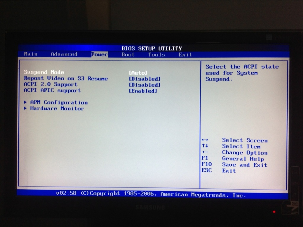

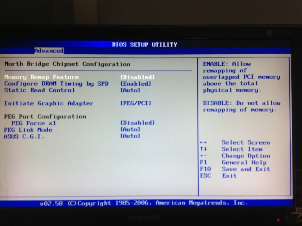

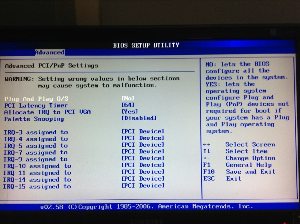

Re: Mixing in Scope - Device latencies/phase problems
@JK - i think HPET is called ACPI2 by intel (or so ive googled...)
This is my bios screen (last image is the ACPI page)
(There are actually a few other pages that might matter so I'm posting them as well ...
Your help would be appreciated in regards to optimization ...
(This was a custom build done by a shop that is supposed to be optimized for scope - but Im not really sure it was a great job ...)
- image.jpg (163.55 KiB) Viewed 6009 times
- image.jpg (230.31 KiB) Viewed 6009 times
- ACPI2 page
- image.jpg (156.13 KiB) Viewed 6009 times

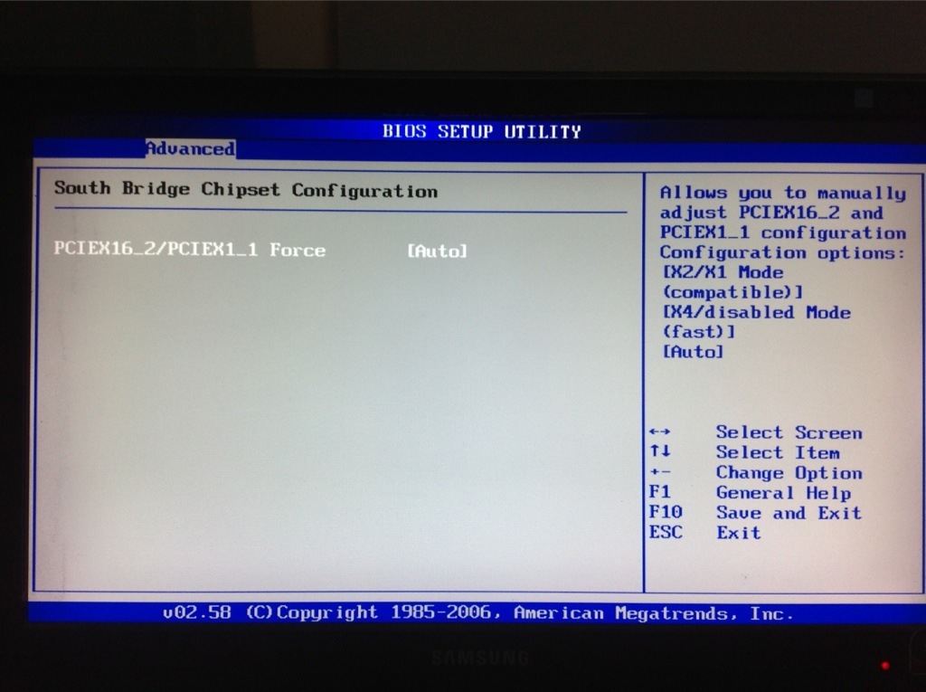

And the southbridge :
(I actually dont think I am using any PCIE .... Can I check if I am and if not - disable it ?
- image.jpg (166.37 KiB) Viewed 6009 times
