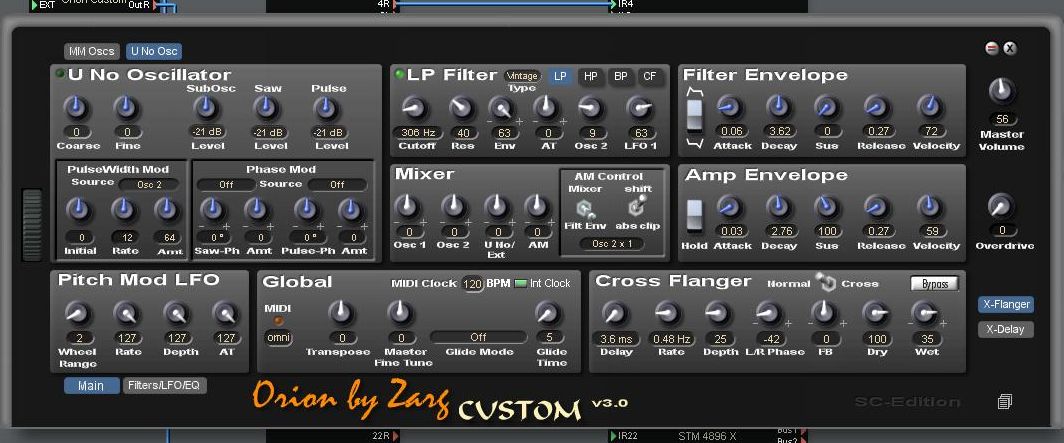

Here's my screenshot I just took a minute ago:
Re: Scope NSA Offer 2: All Zarg synths (Solaris, Quantum Wav
Posted: Sun Sep 22, 2013 7:57 am
by yayajohn
yes that's the one I have as well
