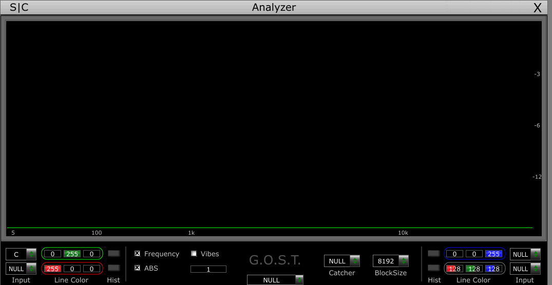

I'm guessing when fully zoomed out the volume, y axis is exponential. As on a pic on the side it goes (from bottom to top) 12, 6, 3. So all the stuff under 12 is going to be crammed up. 12 to 100 is taking up the same visual space as 3 to 0.

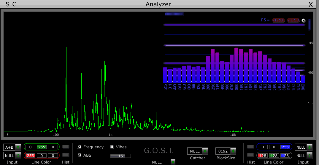

Heres a result from playing a piano sound from MIDI. First, a low 'C' ( 2 octaves below middle c) then a high C ( 3 octaves above middle C ). So 5 octaves apart.
So in the course of a norrmal rock mix, most of the activity takes place on the left hand side of the graph.
I'm assuming thats normal due to bass needing more energy at audible levels than higher frequencies ?

I don't have the plug in, but I see on Dante's screen shot, that the scale is not even. Harmony wise, the distance from 100 to 1K is the same as from 1K to 10K. So it is natural to have the bass area peak higher because it has more "notes per pixel". This is the usual thing with FFT analyzers b.t.w.

Someone post a pic with the y axis (volume) fully zoomed out.
Or Dante do that exact same thing you done with the y axis fully zoomed out.

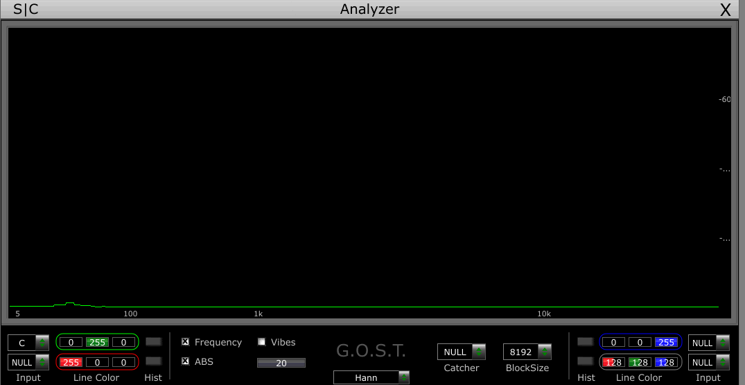

How do I do that ? Is that the selection box with the '20' in it ? Or something else ?
Re: New G.O.S.T Analyzer plugin
Posted: Thu Jan 03, 2013 1:54 pm
by Liquid EDGE
Yes. Pull it from 20 to 1.
Posted: Fri Jan 04, 2013 11:44 am
Ok, more even height wise but still all on left hand side. This would be to do with horizontal range rather than vertical scaling, so do we need user definable horizontal range ? EG 5 to 10K would use all the display on some of my mixes but still tapered high left down to low right.
At a Scale of '20', I put through a commercial remix of Bon Jovi 'Dead or Alive' and it went up to 15K, but again, as per your original observation, the bottom end was showing way higher on the graph tappering down to the right hand of the graph where it disappeared altogether at 15K.

I thought there was a problem with low frequencies being reported at higher values than high frequencies.
Frequency displays are typically logarithmic (in the x-axis as shown here), so this isn't unusual. When it comes to determining energy content, or looking at octave bands, this is actually really helpful and mimics how our ears hear. (Octaves double in frequency with each octave, so a linear sweep up a piano keybed is a logarithmic sweep in frequencies).

a meter like this shows absolute values, not a weighted db per octave scale. it's working correctly afaik.
Posted: Fri Jan 04, 2013 7:14 pm
Weighted dB per octave - interesting. That's what the Scope Analyzer-30 (which also comes in a blue model) must be doing then. Shown here on Bon Jovi mix :

The volume is displayed exponentially right?
As fully zoomed out on the volume axis you have equal spacing
between 0-3 (3) 3-6 (6) 6-12 (12) 12-100
When you zoom in and get closer to looking at 100 the roof of the visual display is that still 0 or is that flying off out of sight?
