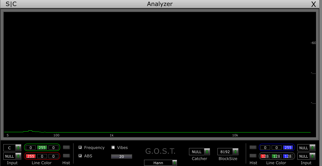

Re: New G.O.S.T Analyzer plugin
Someone post a pic with the y axis (volume) fully zoomed out.
Or Dante do that exact same thing you done with the y axis fully zoomed out.
How do I do that ?  Is that the selection box with the '20' in it ?  Or something else ?
Yes. Pull it from 20 to 1.

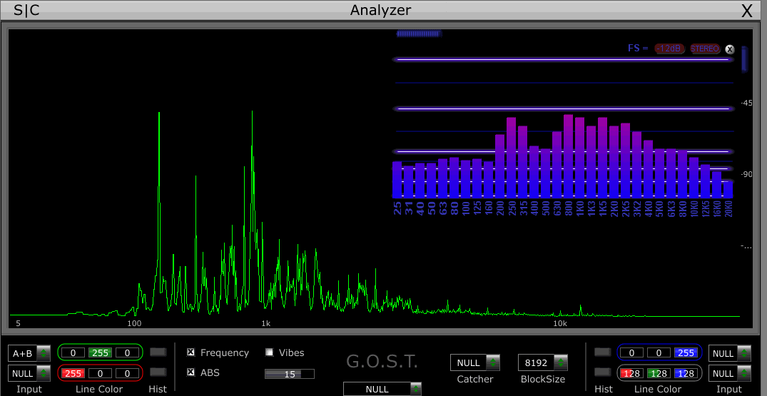

Ok, more even height wise but still all on left hand side.  This would be to do with horizontal range rather than vertical scaling, so do we need user definable horizontal range ?   EG 5 to 10K would use all the display on some of my mixes but still tapered high left down to low right.
At a Scale of '20', I put through a commercial remix of Bon Jovi 'Dead or Alive' and it went up to 15K, but again, as per your original observation, the bottom end was showing way higher on the graph tappering down to the right hand of the graph where it disappeared altogether at 15K.
a meter like this shows absolute values, not a weighted db per octave scale. it's working correctly afaik.
Weighted dB per octave - interesting.  That's what the Scope Analyzer-30 (which also comes in a blue model) must be doing then.  Shown here on Bon Jovi mix :
Thanks Garyb great reference !

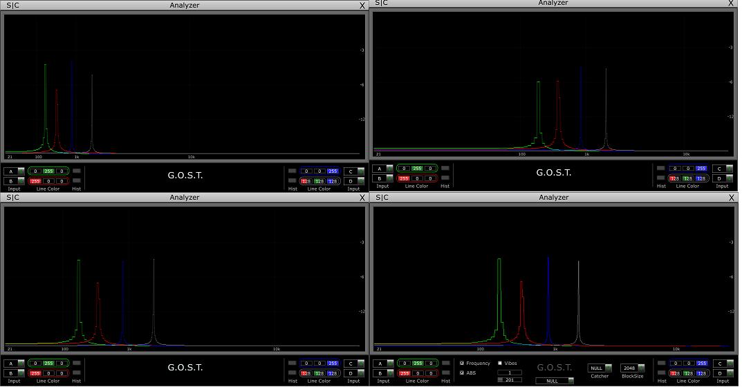

you are watching blocks of 8192 samples;
some high frequency does not go over this full time;
so they will not show full energy;
for higher frequency use a smaller blocksize;
check with a sinus at high frequency that stays on over the full periode of 8192 samples;
and catch it to have the same phase;
the x axis shows most possible measurementpoints by having a loglike scale in the fundamental range;
here you see 220 440 880 1760 Hz at different x axis stretch with a 2048 blocksize;
there is not much difference in all of the views with different stretch;
good vibes
thomas

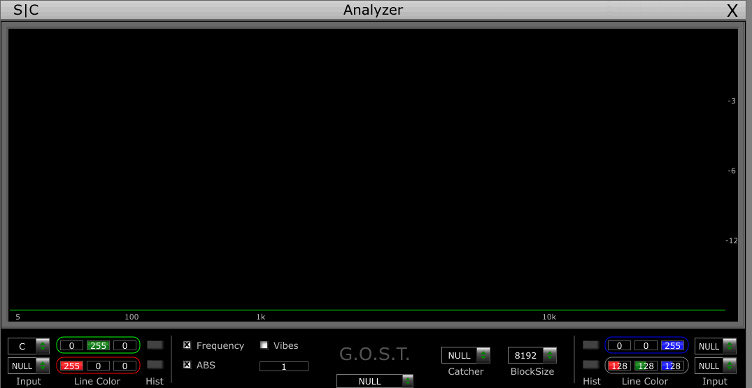

The volume is displayed exponentially right?
As fully zoomed out on the volume axis you have equal spacing
between 0-3 (3) 3-6 (6) 6-12 (12) 12-100
When you zoom in and get closer to looking at 100 the roof of the visual display is that still 0 or is that flying off out of sight?
