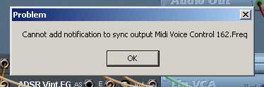

2.) When connecting the frequency out of an MVC to the frequency in of the Random Signal generator I got this error:
Am I doing the wrong thing?

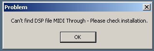

3.) When I open the Circuit Level Module, I get this error:
Any ideas?
Any ideas?
Thanks again,
Ben
Midi thru dsp can be found on the first page of this thread. Just scroll down ;)

Ben Walker wrote:When connecting the frequency out of an MVC to the frequency in of the Random Signal generator I got this error:
No that's a 'feature' [erm...cough, splutter] :lol:
It's because of the way the panel frequency control is implemented at the moment. You'll get the same error message for the other LFO modules. I can either remove the frequency control from the panel (like I've done with the Oscillators and Filters) or there's another option which will solve the problem, but make the modules use a little more DSP ...Still thinking about it.
Ben Walker wrote:When I open the Circuit Level Module, I get this error:
Any ideas?
irrelevance wrote:Midi thru dsp can be found on the first page of this thread. Just scroll down ;)
That's the one :)
I think I should be able to replace the thru module in there. I'll look into it.
