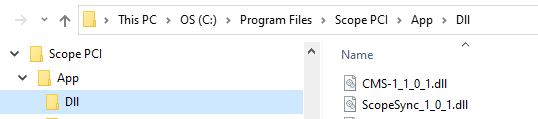

When I run the installer on this Windows laptop, this is what ends up in my Scope PCI folder:

Try running the cms installer again and pay close attention to the directories tab. Do you see that dll file in your scope xite/app/dll folder?

Yeah it’s there.. 🤷‍♂️
Installed again as well.
