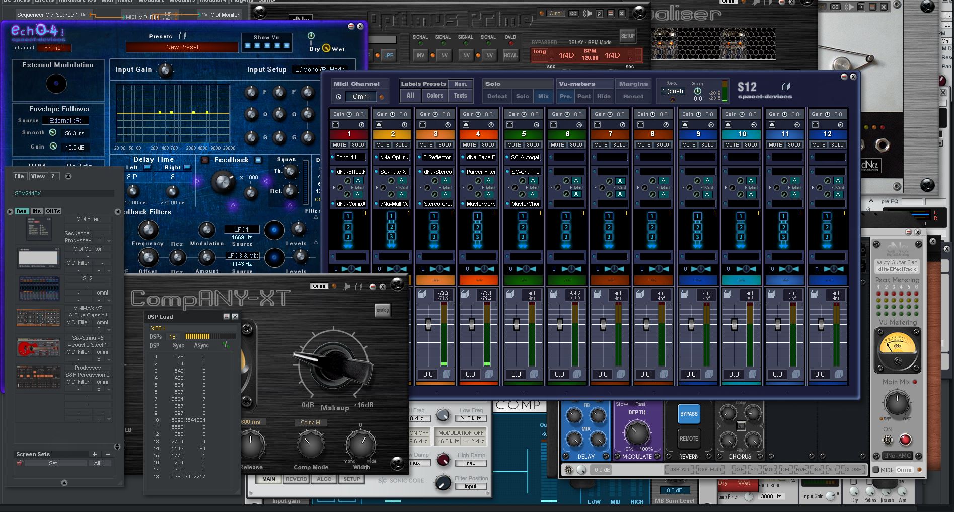

Posted: Sat Dec 16, 2017 7:29 am
by yayajohn
Anyone doubting whether the V7 upgrade is worth the money, here is proof why it is totally worth it.
Finally a fully armed and operational battlestation!
This was all loaded up with NO DSP optimization or SAT connection Pop-up windows. V7 automagically assigned and distributed the load.
Yay!!! I could have loaded more too!
