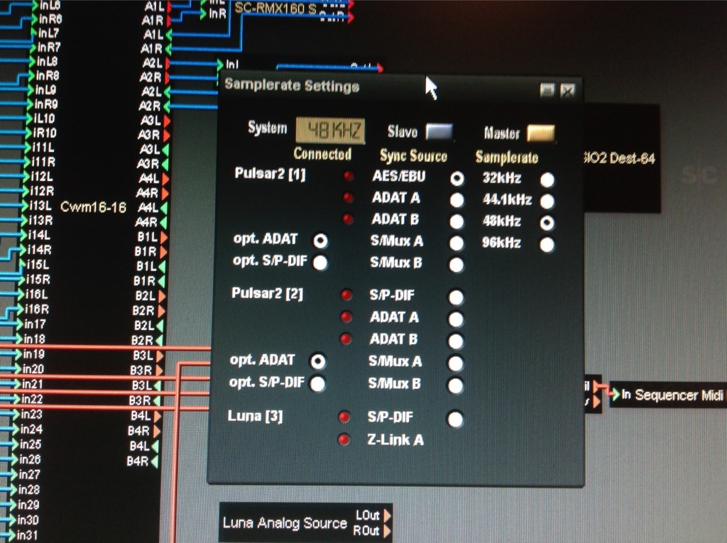

Yogimeister wrote:I thought that maybe SC runs on a faster internal sample rate or oversamples ... It was that "48K internal processing" comment that threw me off ...
In any case, Im trying a 48K project now (to see if I can capture the scope synths sound better ;)
Regarding syncing my daw to the scope clock (having cubase externally clock) - is that more about the sample rate or midi ? (Does it sync midi signals/packets ?)
(My "jitters" occur on monophonic and sparse midi tracks with no automation and a low cpu load ... However, these issues seem to stem from jitters with the output midi from cubase (hence I am thinking of externally clocking it - or going into the "vst system link" settings ...)
Any thoghts/experience on how this would relate to this problem ?
(P.s. I corrected myself, the jitter is in ms , not samples...)
midi sync and audio sync are two completely different things. the samplerate does not affect midi. of course midi is handled in packets. all digital data is in packets. networking is networking.
midi = jitter, period. it's never sample accurate.
computer midi, ANY computer = more jitter than dedicated hardware for reasons explained above.
as to the "48k comment", MANY Scope internals are at 48 BITS. if i ever wrote 48k, it was a typo.

I imagined that since SCOPE has a buffer (of several ms) it could get the (timestamped ?) MIDI packets and trigger them in time - even if they arrived a bit late ...
(That seems to be what the midex does)
In any case: tgt, qpc ... I am trying to sync cubase to a SCOPE clock (instead) - if thats possible (which might have less jitter than the OS clocks provide - and might work better at correcting the packet timing when they arrive into scope ...)
Or is this thing totally not feasible ??
(Can I use the ASIO2 clock input for that - for example ??)

Yogimeister wrote: In any case: tgt, qpc ... I am trying to sync cubase to a SCOPE clock (instead) - if thats possible (which might have less jitter than the OS clocks provide - and might work better at correcting the packet timing when they arrive into scope ...)
I fear, also SCOPE is addicted to some mobo/OS clocks too,- the PCI cards as well as the PCIe card of a XITE box or a XITE-PCIexpress card connected to a Windows laptop,- they all use computer reference clocks.
That´s why I mentioned RME in my former post.
P.ex., you have a RME audio card may it be PCI or PCIe ...
The card offers a MIDI I/O,- just like a SCOPE PCI card (or XITE box) ...
The RME card will use TGT and will probably work better w/ system time stamp being un-checked.
The SCOPE card may behave different when you use it´s physical MIDI I/Os in standalone mode only, but when Windows comes in the ballpark w/ Sequencer MIDI Source/Destination which are nothing more than drivers, you will run into the same scenario than w/ any other MIDI interface out there and it will use some reference clock.
