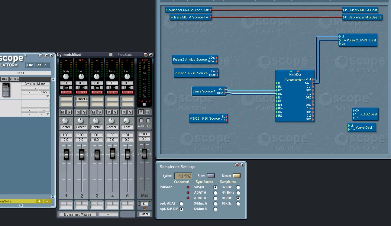

Re: background noise
Posted: Sat Feb 28, 2009 6:45 am
by electrolover
you mean this? if i set like this i hear no sound at all.
Posted: Sat Feb 28, 2009 6:52 am
by Fluxpod
Yes thats what i mean.The signal is comming from the soundblaster i guess.The soundblaster can output s/pdif and no adat.The connectors look the same but the protocoll is different.if you want to use the adat a port then you should connect the soundbaster via a 75 ohm rca s/pdif cable to the s/pdif input on the cable whip of the scope card.The adat port on the scope card can be s/pdif OR adat.But not both at the same time. :)
Edit to clarify,the coax s/pdif in/output on the cable whip can be switched to optical s/pfdif which uses the (adat) port a.

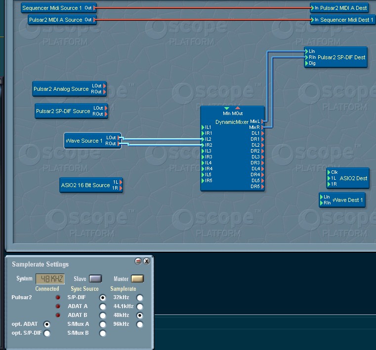

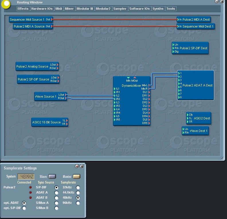

valis wrote:Show the FULL window please, not just that setting.
ok here it is full. this config ok for adat b but adat a does not work. if i select opt.adat on samplerate settings window, all sounds stop.look below;
or

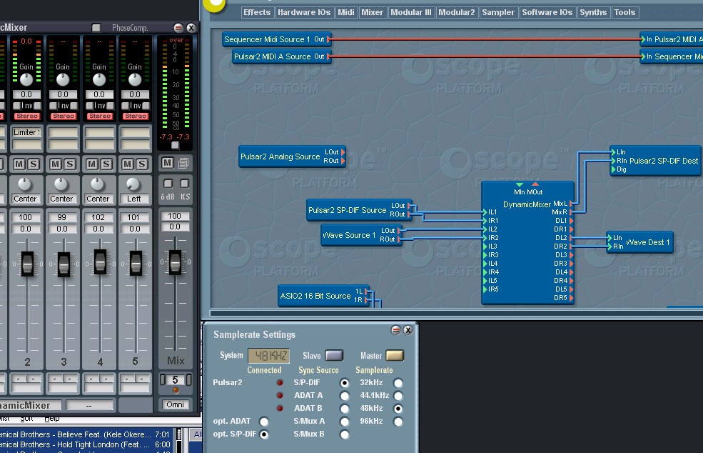

Posted: Sat Feb 28, 2009 9:07 am
Again nothing wrong.
From the Scope manual under "I/Os & Drivers":
opt.ADAT selected: Each optical I/O operates in ADAT mode (standard)
opt.SPDIF selected: The ADAT A optical port switches to S/PDIF mode. The S/PDIF output signal is transmitted over both the opitcal and the coaxial outputs. The optical input receives S/PDIF signals, and the coaxial S/PDIF input is disabled. Use the normal S/PDIF source and dest modules in the routing window
So, you're using the wrong settings and the wrong i/o modules for SPDIF. Set it to Opt. ADAT on the left and use the SPDIF modules *only* in your routing window (completely REMOVE the ADAT modules). Sync source should be SPDIF also (it is in your screenshots, that part is correct). Once that's done you then need to figure out if the Soundblaster wants to be in master or slave mode when used via spdif. Set the Scope master/slave as appropriate (the soundblaster will probably be fixed).
(edit: the two posts above came in as I was typing mine :P )
