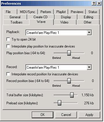

Valis, Thanks for the post, but sorry to say I am none the wiser for your description :-? I appreciate that drivers for hardware have changed over the years...but I dont understand the way you are relating this to soundforge. On V5 the only reference to drivers I can find is the wave settings in the preferences page. (see attached jpg) is this what you mean. As I understand things, Soundforge, being software, uses the drivers of the hardware, in this case Scope, to utilise it's inputs and outputs. Ref Direct sound, to quote the Scope manual " There is no Direct Sound dest module, as this interface is defined as unidirectional. Communication is possible from a Direct Sound source to the SCOPE Fusion Platform, but not the other way." Ummh, so I don't think I am getting your point .

I went into some detail because I don't have Soundforge 5 here and couldn't see what settings were available, your screenshot helps but there are also other factors that may affect things (some examples have been mentioned through this thread).
Also the 'directsound' module that comes with Scope is to be ignored completely. This was intended to allow sound to be routed from an onboard chipset or sblive type card into Scope, and hasn't worked since Win98. When I referred to directsound I meant as an API (something programmers care about) which might be an option in SF 5. For instance in winamp you have the choice between Wav/mme and 'directsound' output modules, wav/mme will yield far better results with a scope card.
Can you also post up a routing screenshot to compare to that settings panel? Ie, 24bit wav drivers or 16bit etc.
"try to open 24bit" might be good to check, adjusting the lower 2 buffer and preload settings might really help.

what about buffer and preload settings?

I have tried every single setting of preload. In Audition I have used the standard setting and the following :
Total Buffer Size = 2 seconds, using 16 buffers
Wave Cache Size = 32768Kbytes
Cheers
