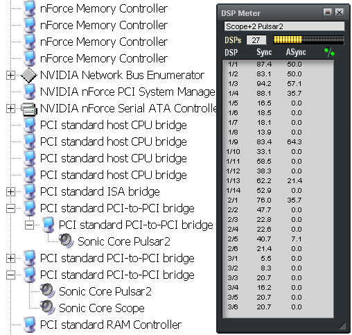

For now, I've added this 6DSP XTC-card with no IO, and I've only loosely hung it inside the PC case. No MV testing, just loaded yesterday's project.
The ultimate test ofc would be to move all 3 DSP cards to those expansion cards (I have 2), for those motherboards who don't even have PCI slots. But I don't have a need for that nor a proper machine for that now, and also..
The ADAT connectors on my other cards (Scope, Pulsar2) aren't too convenient to remove and insert (quite some force is required for that, damn metal connectors on the cables), so this is ok for me - for now. Later I may go look for an extra IO board, but I'll have to jump that bridge when I cross it ;p
edit: the PCIe to PCI adapter card, €12.5 at time of writing: https://www.aliexpress.com/item/32849431927.html and the extension cable: https://www.aliexpress.com/item/32857626033.html

Gigabyte aorus z390 no pci slots
Added oem pcie to pci card with same chip
Loads with Pulsar2
8 Masterverbs
No errors
Also loading a Pulsar 1 rev1 - but this card can cause worldclock errors when loaded alongside Pulsar2 in certain pcie slots, however which combination doesn't work hasn't been fully tested
Thank you for the heads up on this solution - it's much quieter this way than a 2nd pc
