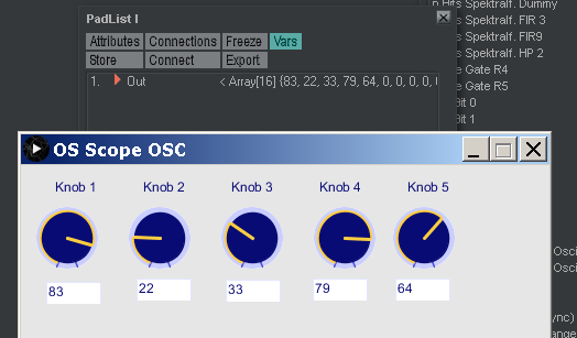

				Posted: Wed Dec 20, 2017 10:10 am
				by faxinadu
				going really good now
- weeee.png (12.79 KiB) Viewed 388041 times

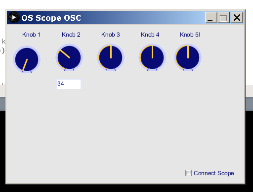

				Posted: Wed Dec 20, 2017 1:47 pm
				by faxinadu
				RAd!!!!!!!!!!!!!!!!!!!!!!
- scopopop.png (20.29 KiB) Viewed 388027 times
