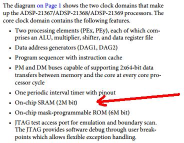

Re: Scope 6 does not exist
Posted: Thu Oct 08, 2015 11:23 am
cortone wrote:My bad! Although I didn't actually find any images on Scope Rising that show the memory chips, you guys know hardware. Which article is it in? I have some images from way back, but the memory chips must be on the opposite side of the board from the sharcs, they don't show in the pics that I have.
Yes, which article ? I need to check that, if its referring to RAM onboard the ADSP or not. Coz according to this http://www.analog.com/media/en/technica ... _21369.pdf
Its 2MBit per chip - which is what - 150K bytes ?
SRAM
SRAM
At that rate, maybe we could place a couple of velocity layers of a single note of a piano on each chip, then use up the SAT connections to join them up into a complete octave :lol:
Posted: Thu Oct 08, 2015 12:03 pm
by cortone
Dante,
I found that reference too, but I recall that there are additional DRAM chips on the XITE board, although I can't find any reference to it on SonicCore now. The only pix I can find show the topside of the mainboard inside the XITE, but no DRAM chips, just the Sharcs, are visible. I haven't found a pic of the other side of the board.
Cory
Posted: Thu Oct 08, 2015 12:06 pm
dante wrote:
... Coz according to this ...
Dante, the information never came from Scoperise.
IIRC, it came up much earlier and there isn´t that large RAM inside the SHARC chip,- but XITE onboard RAM should exist.
Already in 2009, Jimmy mentioned to the Xite-1´s 12 chips attached RAM as he also mentioned Juergen ...
https://www.gearslutz.com/board/music-c ... 1-a-4.html
He says 64MB RAM chips here which might be wrong though.
Later it came up here PlanetZ again and w/ site of 32MB mentioned.
My XITE-1 came march 04 / 2012, so it must have been later because I didn´t discuss XITE before.
It´s too many threads, pages and posts to find out when it started, but it might be mentioned somewhere in the masterverb test thread or posts about users (fra77 and/or djmicron) working on XITE-DSP optimized devices.
At least fra77 used that onboard RAM tweaking masterverb and a chorus for us.
He´s gone and deleted content of his posts I fear,- and I regret he isn´t with us anymore.
