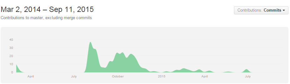

You can see the impact of becoming a father here :wink:
Still working on it, but it's taking a lot longer now!
Also, apart from a few individuals, there's not been a huge amount of interest. It was a massive effort to get to the last version of ScopeSync, including all of the work on the tutorial videos etc. and I'm guessing there's probably fewer than 10 people actively using it.
Would be great to get more feedback on what's really important to people, as there's lots of people complaining that they don't have Scope 6 yet, but not many prepared to help with an alternative path to enhancing what we have.
