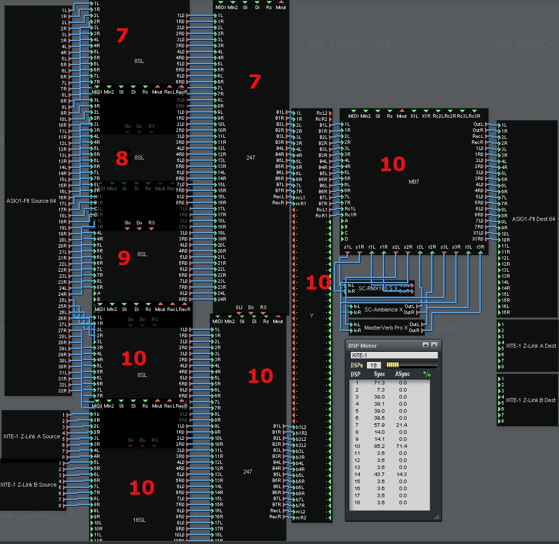

In my old project i placed all modular-mixer-devices on dsp 7-10. My mistake was: all asio channels were routed to dsp 7.
Now - following your tips - i divided the ASIO-connection onto the dsp 7-10 with 16 channels on each.
XITE proudly presents: 64 channel ASIO into modular mixer, with 20 channels ASIO-Dest for recording via cubase!
OK, it is not perfect - at the end i had to place many devices on dsp10, this could be a problem when adding effects in the future.
After saving and loading all modular devices seem to be on the same dsps (according to the DSP-Meter).
Now i can load some instruments:
- Six String, Vectron, Minimax (6 voices each), B-2003 (these don't remember the assigned dsp after loading).
Cool - who needs so many ASIO-Channels

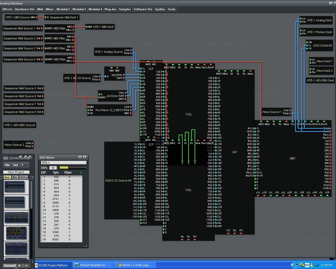

Re: Modular Mixing
This is my project which worked pretty well for the last 2 weeks:
1x 12SL connected to a sidechainer 12 ch both assigned to dsp 7
1x 12SL connected to a sidechainer 12 ch both assigned to dsp 8
247 Router assigned to dsp 9
MB7 assigned to dsp 10
Pro One and Prowave are on dsp 16 and 18
Filters on all channels are on.
I have the PCM91 inserted as AUX fx in the MB7. (i dont know if these internal connections have any influence on sat errors or other problems but I havent experienced any problems whatsoever)
I have inserted some fx in some of the mixer's insert channels occasionaly but I have to check further in the project how this will evaluate once adding more fx. When inserting an Echo 35 as an aux fx I get a large number of async (not in this picture). I also need to recall presets or reload the effect because it doesnt recall the presets.
Im pretty happy so far

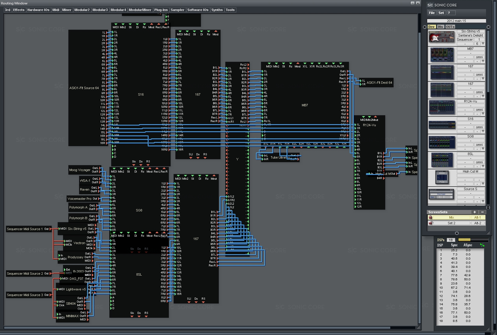

Re: Modular Mixing
Here goes --
I've kept the mixer mostly in slots 2-3, so the rest is available to various synths & effects for base. Mix7 also has an RMX160 inserted, and MB7 has a few effects inserted as well.
- jk* modular mix project #1
- ModMix1.png (212.22 KiB) Viewed 4505 times
DSP 1 & 2 are the actual ASIO and Hardware I/O's.
VDAT also works in 3 x 8 config on x64 if assigned to DSP2.

It's the only mixer that use such little values, and makes me believe that his tenure was limited and prioritiazed.
Even the 5.1 Room Reverb takes little DSP compared to the STWs as there is limited editing, but I can place several of them in an STM project and run w/o ER's and in Stereo and get great results.
We need someone to optimize the DSPs better, or re release a new Scope DSP platfotm like Bowen has on Solaris.
Old chips arent needed for communications there....
I am still quite a happy customer and the unit has paid itself off several times. It's sound quality reeks of dedicated RISC Processing, so no complaints. Just an observation.
Next time your buddy with a UAD Quad shows you his effects rack you will see what consistent optimiaztions really are capable of.
For example the Studer Tape Sim is realtime and can be used many times. Ever see Nebulae do that.......?
So DSPS are the way to go no doubt, but 3rd Party " Communication " at UAD seems to be a serious advantage.
Its likt RP001 showed. Less ASIO inptuts to the destination module from an unoptimized Scope mixer the better.
I also learned that I can have many ASIO direct out from the STM2448 into ASIO Destination.
It's the only mixer that does this to my knowledge. It also allows major inserts through its routings.
My take is the Klaus Piehl left after a certain amount of optimizations were performed, and anything made since then is subject to limitations.
Just look at the meger DSP values displayed when using an STM2448 with 34 ASIO Ins and 50 ASIO Outs.
