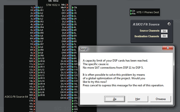

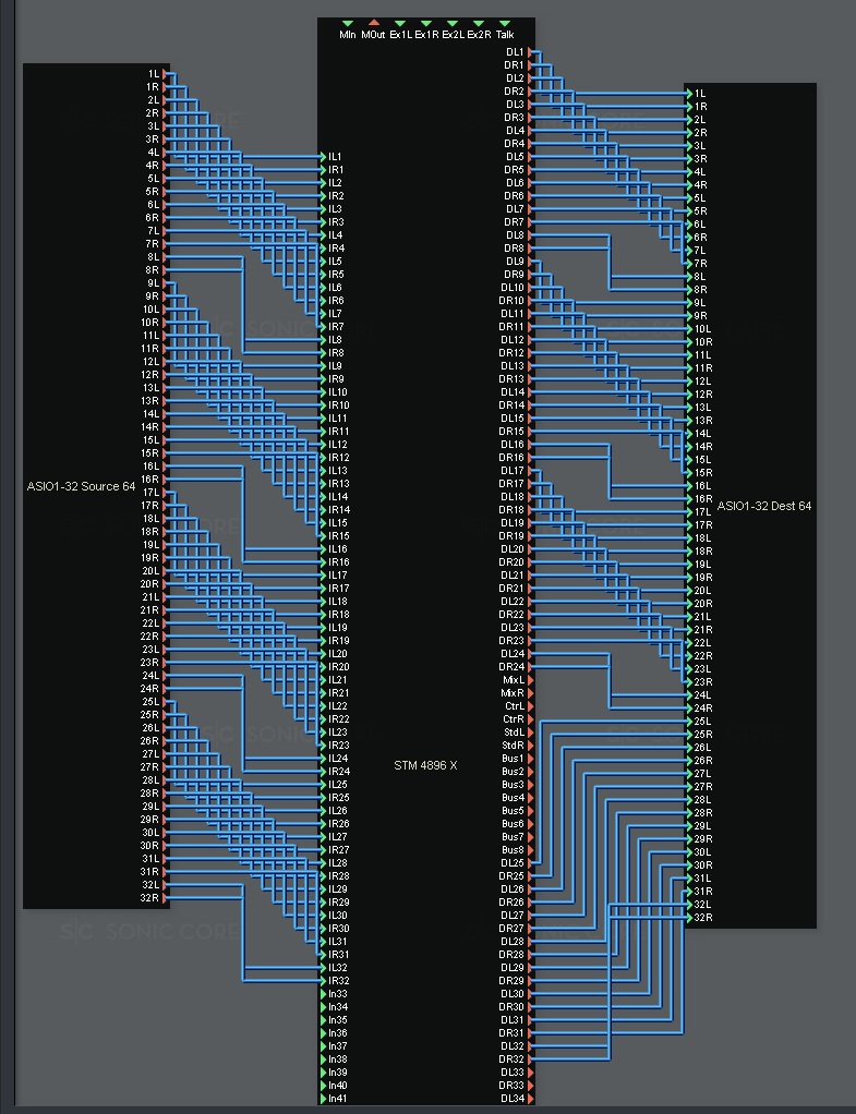

I've done a bit of experimenting with this and I think it's just a problem with the 1632X mixer. I can actually hook up 64 ASIO Ins and Outs now if I use the 4896X! (see pic)
I made sure to actually try out the channels in Ableton Live, so they're definitely working.

same in 5.0.2619 (x32) vers. 1632 mixer is not changed since then.
- err.jpg (110.73 KiB) Viewed 4652 times

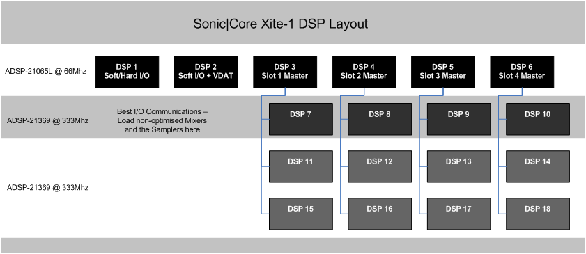

P.S. tjsound: the picture was my handywork, to help me remember the Xite-1 internal layout for dsp allocation.
- Xite.gif (20.07 KiB) Viewed 4561 times
Re: 64bit Testing
Thanks for the chart - very useful
I downloaded it a turned it into a PDF and stuck it in the Manual directory.
regards
regards

I made it a screenshot...........
