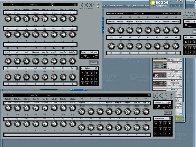

couldn't resist to test the unfold version straight away but I think there are some align issue in v0_6b ...
Tested on a 1280x960 display with Scope 4
Upper Left and topdown are v0_6b with alignement trouble.
Topright is the former v0_6 with correct alignement ...
Screen resolution doesn't really matter actually.
Would be great additionnal feature though :D

HUROLURA wrote: Upper Left and topdown are v0_6b with alignement trouble.
Looks fine in Scope 5.1 for XITE-1. However, if I move knobs whilst a sequence is playing the sequencer just stops and has to be restarted (the Start button is still lit, so has to be switched off and on again).

HUROLURA wrote:couldn't resist to test the unfold version straight away but I think there are some align issue in v0_6b ...
OK I've figured out that's a bug in Standard mode. It works fine in Scope Classic mode.
Strange thing is the knobs which are moving position are the best aligned :-?.
I'll see what I can do with it :wink:
Mr Arkadin wrote:Looks fine in Scope 5.1 for XITE-1. However, if I move knobs whilst a sequence is playing the sequencer just stops and has to be restarted (the Start button is still lit, so has to be switched off and on again).
