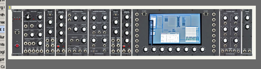

wot, like that :)

Could be nice ...

Now that's jaw dropping and drool worthy
