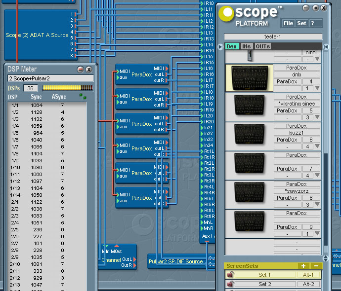

Had a quick go with paradox today, Nice how you can run 4 of these with a total of 7 Voices and still have power left for an effect or two on a 9 DSP system.

Heres something silly., but check out the horns at the end,
everything is paradox except drums and there is a little delay (kp3)
all recorded in 1 go.
- 6pd.jpg (184.12 KiB) Viewed 3771 times
