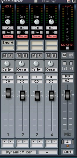

Re: background noise
Posted: Sat Feb 28, 2009 4:38 am
by electrolover
hello everybody,i have to say all of you very helpful people which i didnt expect much.
my opinion, scope best of the best audio card. some people comparison with m-audio :) from my country funny isnt it?
anyway, thank your opinions and ideas.
i use my compressor on digital a and blew up everything.nothing changed.digital a did not work.

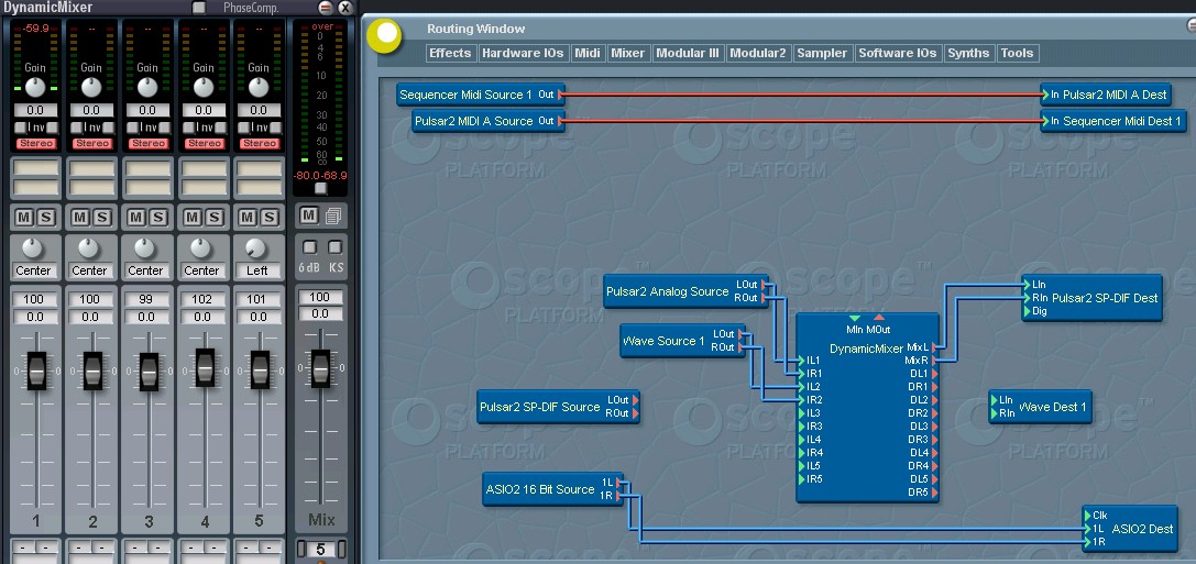

i've just tried this (please look at the picture) and noise gone. still, there is problem with noise but when i receive little a/d converter (you can buy from ebay for 68$ shipping included) iwill remove analog source so my system would be noiseless again (im sure you know, when you buy this a/d converter only expect connection between analog and digital cables nothing more, if you want real a/d converter buy pro like rme or apogee)
i also use expander on analog source...
Posted: Sat Feb 28, 2009 5:46 am
Do us a favor and post up a pic without the expander, and without the -12db input gain (leave the channel's input at 0.0)

valis wrote:Do us a favor and post up a pic without the expander, and without the -12db input gain (leave the channel's input at 0.0)
Posted: Sat Feb 28, 2009 6:07 am
Skip the expander.
Tell me again what is connected to the card's XLR inputs?
Posted: Sat Feb 28, 2009 6:13 am
by electrolover
valis wrote:Skip the expander.
skipped expander and all default. classic i/o no xlr in/out. rca plugs.
nothing connected currently. toslink in/out (adat a) not working, b is ok.
except adat a and analog source noise remains ok.
