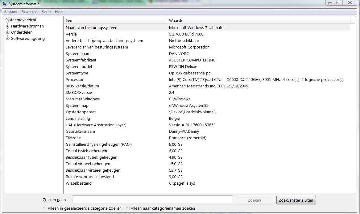

microraver wrote: ???? I'm using here Win7 Ultimate 32bit with 6 GB ram !!
Sorry, but you're not. Go to Start/Control Panel/System.
It will show how much ram is installed. It will also say in parenthesis that only "(3.5 GB usable)" if you have over 3.5GB installed. The OS doesn't use anything over 3.5GB even if it shows more available. It is impossible to address more memory space than this using 32bit architecture.
So, that extra 2GB you have installed is sitting there doing nothing.

microraver wrote:
iSiStOy wrote:Let me just add that it's not because you see 8 GB in your 7's task manager that the OS is able to use it.
This is a question of being able to address such memory ranges, with 32bit.
Ok ,here it is ,see attachement or jpeg !!!
But iSiStoy is right. You don't see what he talks since you have localized windows version. See this:

Re: SCOPE 5.1
Posted: Mon Aug 30, 2010 9:59 am
by microraver
For all the UnBelivers , try msinfo32 and see what you have !!
Here is mine !
