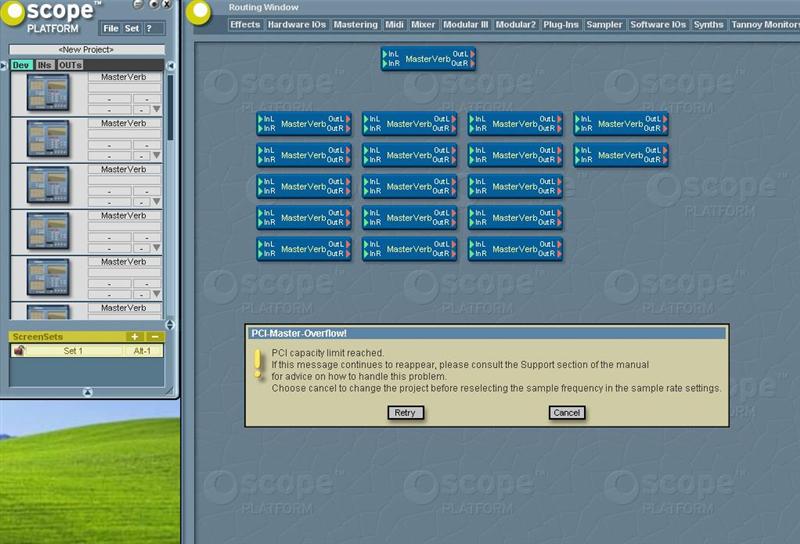

Fluxpod
Posts: 1140
Location: Telefunkenland
Post by Fluxpod »
So,after installing the p2 to my existing system i did the test again.
Hardware details did not change so see in my above post.
Pulsar1+Pulsar2.
I get 12 Masterverbs on this setup,it complains on Nr. 10 but loads 2 more.I run out of dsp cap then.I guess thats not too bad :)

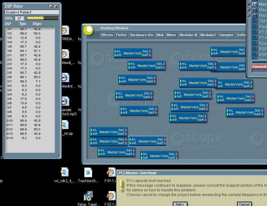

ChampionSound
Posts: 334
Joined: Thu Sep 23, 2004 4:00 pm
Location: Netherlands
Post by ChampionSound »
- Asus P5B533
- Memory 1 GB (brand/type unknown)
- P4 2,0 GHz
- ATI Radeon 9000
-1 STDM cable
- ULLI = 7 ms @ 44.1 kHz
- 2 x Pulsar 2 + Pulsar 2 SRB (18 DSP total)
17 Masterverbs successfully loaded, PCI capacity limit after loading 18th MV (with DSP meter at about 75 %) :)
Masterverb Test Thread.JPG (67.33 KiB) Viewed 6043 times

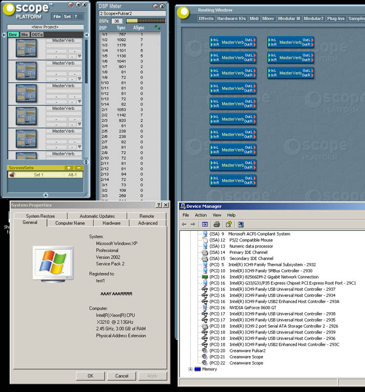

Neutron
Posts: 2274
Post by Neutron »
I havent set the card order yet. its using the scope 14 with no memory as first i want it to be last.
first reboot after installing everything
i got "dsp memory limit reached" after 13 .
supermicro CS2BE
pulsar2
scope SRB (14 dsp, no mem)
scope 15 dsp
geforce 8600 passive underclocked.
xeon x3210
4gb ocz budget ddr2 800 kit (2x2gb)
no optical drive.
corsair 450w PSU (will change for a modular one, too many cables im not using all over the place)
supermicro has very advanced overclocking! it says 5%, 10% and 15% :D
i set it to 15 so its the same as a q6600, seems to run cooler though.
this chip will go back in its home in HTPC when the new 45nm q9450 is out :)
disabled all the stuff like audio, extra PCI-e slots, serial, parralel floppy etc.
no optical drive, installed by USB flash drive!
the board seems much more geared toward a professional use than any of the taiwan/chinese designed ones. individual settings for each PCI slot latency, busmaster etc.

My supermicro CS2BE had a tragic accident involving a defective ebay USB hub. now it wont boot.
Use powered USB hubs for the first one connected to your PC!
so i got a gigabyte p35-DS3R, which is actually very nice for the price. it seems well made (taiwan not china) has all solid caps blah blah blah. but the colors are a bit hideous. asus does not make any card with 1 graphics and 3 adjacent PCI slots, besides i have kind of gone off asus lately.(i never though i would say that, times change!)
It gives me 3.5GB of 4GB in windows instead of 3GB. i believe because there is not an additional graphics card slot.
BUT on the cs2BE all the Scope and pulsar show up together on IRQ22 but on the D3SR they are all different and mixed in with what look like about a million different USB related things (usb host, usb2 host etc etc)
i just used my previous install because chipset and almost everything was the same, except ICH9R instead of ICH9 and different network chip.
A question probably for GaryB i tried setting the ACHI on the hard drives but windows will not boot. it shows xp logo for a sec than a quick BSOD and reboot
do i need a driver or something to use it? and is it worth it, i paid extra for the board because of NCQ supported by my drives.
I had a project with already 2 masterverb pros, and managed to load up 11 more masterverbs in to it before PCI limit. it seems 1 better than the CS2BE
and i changed from quad core to a dual core cpu. xeon E3110(which is the same as core 2 E8400 but easier to find and cheaper AND it has a cooler name!)
just for fun i tried overclocking and it went to 3.5 ghz without even trying (no voltage tweaks etc) and it runs nice and cool with scythe andy modded to a 14cm fan.
at stock speed it seems plenty fast enough, so i returned it .
