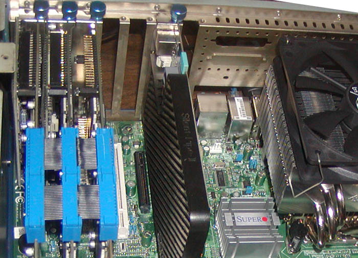

I finally did it.
You can make them exactly for your situation.
The middle one has to be slightly modified with a sharp knife and/or dremel if you want the cable to come out straight, the connectors are supposed to be for "ends" not in the middle of the cable.
The spacing between PCI slots is 0.8 inches, the connectors are 0.4 inches wide, so if you do like this you can use one of the connectors as a guide.
gap between cards_____space between edges of connectors
0 __________________0.4"
1 __________________1.2"
2 __________________2.0"
3 __________________2.8"
looks nice with black cable :) its just asus floppy cable reduced to 20 (take of 14 they are 34 conductors). I stopped using floppies ages ago but they keep giving me those :)
and they STAY ON TIGHT!

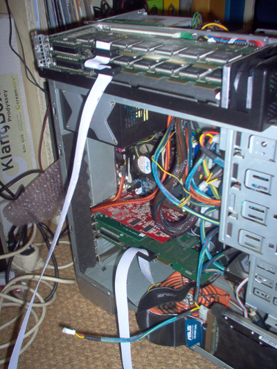

Today, I installed 3 cards on the same computer, only two were in a magma chassis with a PCI interface, and the other was on the PCI slot of the Motherboard. How did i do this? A home made 1 meter long STDM cable connecting the first connectors of each card!
This is great!
The flat cable comes out of the Magma through the open slot (it has 3) in the back, and into an open slot on the back of desktop, so everything is shut. Right now, both cases have to be close to each other, and when I want to take the Magma away, I have to disconnect the stdm from inside the case, but I want to develop this idea further... there must be a way to break a flat cable and insert some sort of plug, so it can be extendable... Like IDE have male and female, but of course the male of the STDM is the connector ot he board...
Something to think about, but for now, I'm HappY!!! :) I have almost as much bw as if I was using the 3 PCI slots (14 MVs instead of 17), but now, when I want to, I can just take 30 of those DSPs out, go play somewhere, and still have a working studio at home, with everything properly connected!
It's still better than pulling the cards back and forth...
Thank you all for this great piece of information! :)

2 PROs in the Magma, 1 6 inside the case. This was just a first experience, the cable now goes from the back of each case :) I made 2 cables, but the other one doesn't work...

so you get reliable function of scope with
a: 2 meter long STDM cable and
b: cards on separate PCI buses?
i never would have thought it possible, 8)

Neutron: yes to both, but only 1 meter cable :)

Neutron wrote: WHat i WOULD do is get rid of the extra cable after the last connectors, especially that long bit.
Yes, well spotted, and it's gone now. My idea was to leave a little bit for a hypothetical 4th connector, but then i realised that the plugs actually open up, and the upper and lower parts separate from each other completely, so I can put the ends first and then any in the middle... live and learn.
So if I understand correctly from Neutron's words, STDM is a data connection, and should be relatively safe to use in such a twisted way. I certainly hope so, as this is the el dorado of scope, as I always wanted it to be!

Neutron wrote:I finally did it.
Can anyone spot what kind of blue connectors are used in this set-up?
