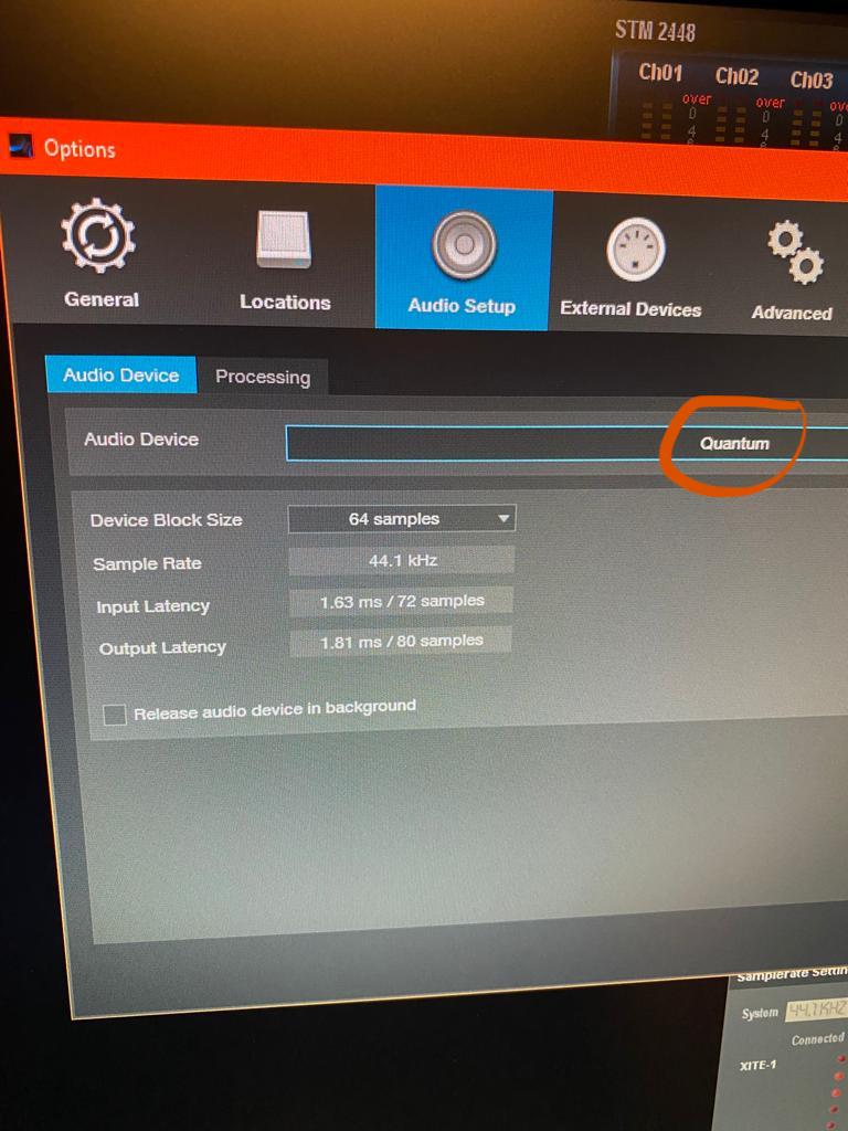

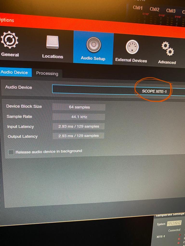

				A bit late to the discussion
I just tested a Thunderbolt 3 Interface, the Presonus Quantum 2626. It's not a realtime instrument and virtual studio, but it does what I need and it does it very fast
As I rarely use realtime synths anymore but need the lowest latency possible for monitoring recording guitars, vocals etc. in the DAW, I decided to try a current and hopefully faster audio interface. I thought pci-e has the lowest latency to get into and out of the DAW. In fact, this is not entirely true anymore, see here for the latency comparison between the XITE-1 and the Quantum 2626
- Latency XITE.jpeg (93.33 KiB) Viewed 17857 times
- Latency Quantum 2626.jpeg (85.81 KiB) Viewed 17857 times
On top, I get sub ms latency with 32 or even 16 samples (device block size) and everything is still a rock solid without any clicks and pops. I know it's still not realtime, but really close
So to make the story short, to be clear, I still love the Creamware/Soniccore stuff and it's still sounding great, but I guess at some point it's in need of a major update regarding host connectivity, MacOS support and DAW integration. A Xite-1 with a Thunderbolt Interface, lower latency to the DAW and Mac support would be fantastic. One is allowed to dream
Not sure yet about the AD/DA and preamps quality compared to the setup I use now with the A16 Ultra and the TFPRO 16x, more testing is needed for sure...
Cheers,
Roman

				Thunderbolt IS PCIe, using TB doesn't change anything for Xite except changing the cable type (and adding some cost for the chipset).
The amount of data that Xite moves dwarfs what an audio interface needs, though it might certainly be possible to update chipsets to reduce the number of safety buffers on the OS side, which is what Presonus has done.  RME already documented that on Windows it's possible to completely eliminate the safety buffer (an additional buffer on top of the ASIO buffer that ensures the data send to and from the audio device is always populated).  This is due to architectural changes in windows and the full virtualization of the PCIe bus which I explained in another thread.
None of that changes the fact that the Xite has to manage much more than just your ASIO buffer, and so the two are only comparable if your usage scenario for the Xite is simply as an ASIO device.

				@Katano the time figures on your screenshot are plain calculated values.
For the real world amount you have to track 2 signals to compare (or do a null test with sample delay).
Iirc I‘ve seen many interface specs where measured latency was significantly larger than what you’d expect from buffer values.
(maybe that‘s due to the safety buffer Valis mentioned, but I‘m not that OS savvy)
				Re: Xite with Usb connector
				Posted: Sat Jan 22, 2022 10:45 pm
				Yes that sometimes is a cause, some only report the actual ASIO (or core audio) buffer size and not the overall software buffer size, some may also report hardware overhead (chipset buffer size in say ADAT or AD/DA conversion paths). So loopback & tracking tests are the right method, you are correct.
