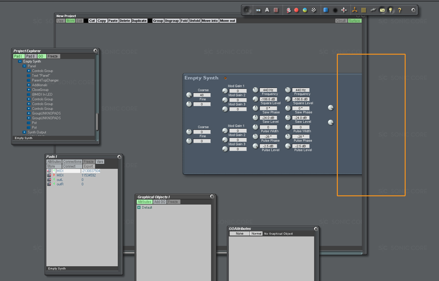

Thank you for the detailed background information.
I'm still stuck at this "movement".
I can group the objects in explorer.
Clicking between poti and display selects the group in explorer, but I don't get that box in the graphics.
I cannot move the group.
So I tried to move the controls group in explorer into the empty synth.
I appears now right to the synth, but I cannot move it.

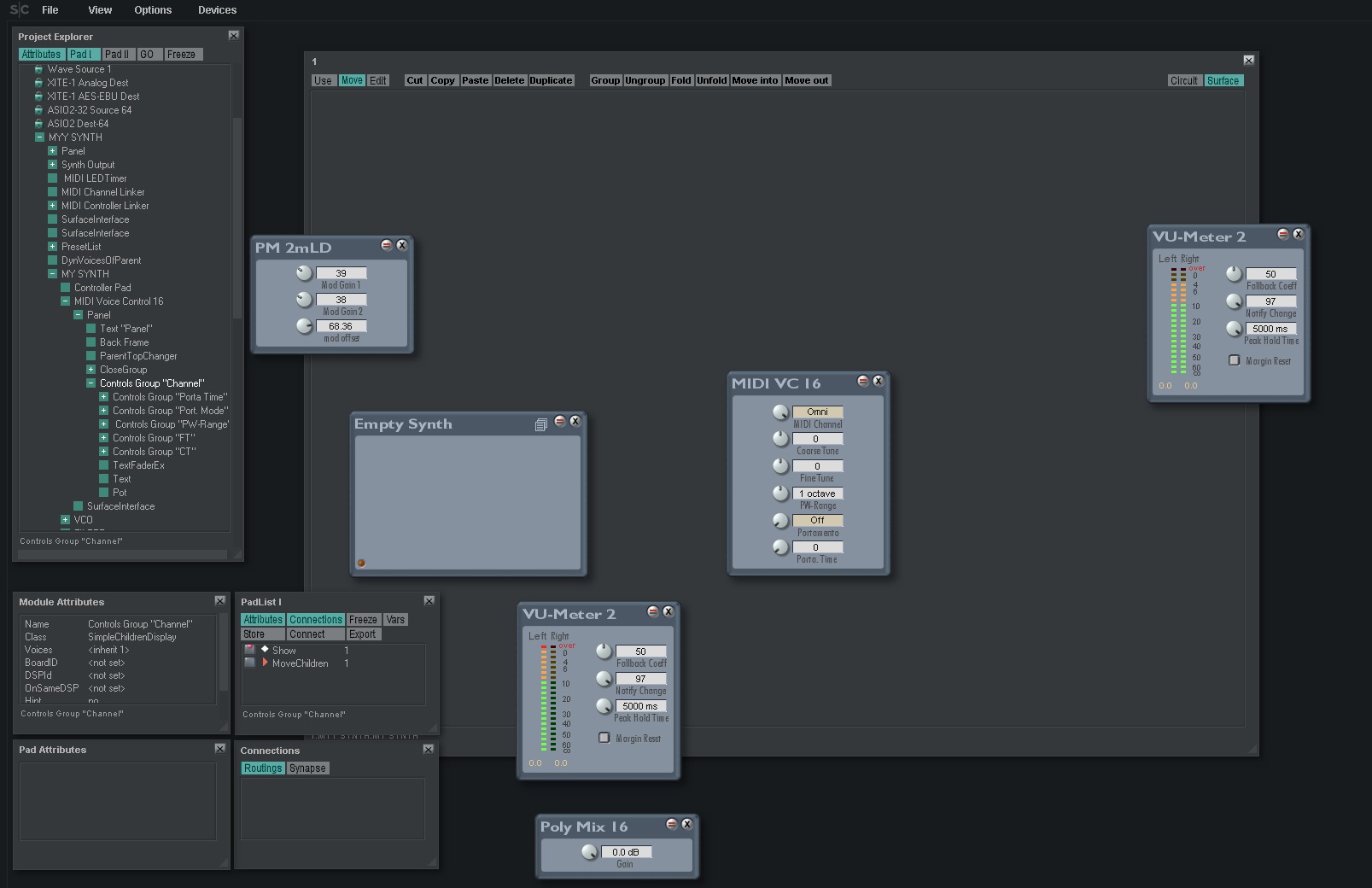

						Re: TUTOR VIDEO - Make a synth in Scope SDK in less than an hour
HI !
This is very weird.
2 things:
1/// what surprise me in your pics is that the synth panel seems to be floating like any "normal" surface that is not in "surface edit/move"mode"
I attach a picture that shows my sdk, with the Project window in "surface" mode adfter the Panel was selected : the panel can go "under" the edges of the window, it is not floating above it, but is contained inside the surface mode window.
yes, what fra77x says is right too. Might be it indeed. I checked on your picture and it seemed correct to me but i have no way to know for sure.
to summarize
The panels are at the same level as the "surface interface+panel" couple.
the panel module "is" the graphic panel of the device (if you delete it, you loose your device panel and all connections of potis/faders to circuit pads.... so don't delete it lol).
pic attached
The surface must be closed too. if it is "open" it may or may not appear in surface edit view (if you right click the panel in surface view and choose "show" the panel should disappear). it must be closed either by going back into surface view, right click panel (in project explorer) and choose "close" (going back in surface view may "refresh" it and the panel/graphics re-appears) , or by selecting the "Surface interface" or "panel" module, and setting the "show" pad to 0 (if you can't make the graphic panel appear again).
							to summarize
pic attached

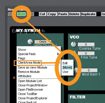

Found another possible cause.
There are two levels of edit/move/use mode
For what we want to do, make sure that
- project window=move
- surface client area mode = move
If project is "move" but client area is "use" , then I do not have dots around the group, i can move it around though.
