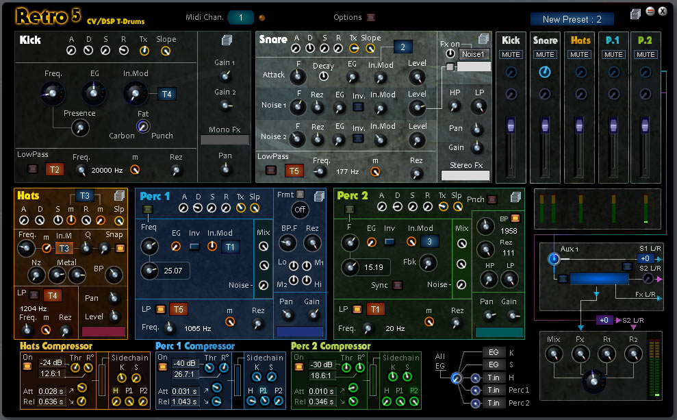

RETRO 5
Same Kick/Snare with hats and percussions that can mimic famous vintage sounds
You want vintage sounds? just make sure all modulations are at zero (except for the hats).
Vintage drums don't have modulators, but Retro 5 does, so it goes beyond cloning.
The color codes are the same as in Aquarius in the case you have colored a midi controller, so using either device will match the colors.

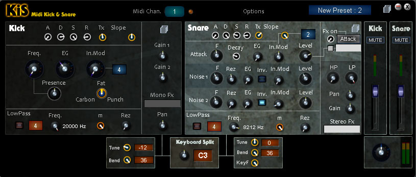

KiS
Kick and Snare to be played with a midi keyboard.
You run in while Aquarius/Retro 5 are in auto-drummer mode.
Simple as connecting the midi input to a keyboard.
Can import Aquarius/Retro 5 presets (same sound not guranteed due to different envelopes and tuning).
Pitched over the entire keyboard, split note is editable, independant pitch bend and master tune

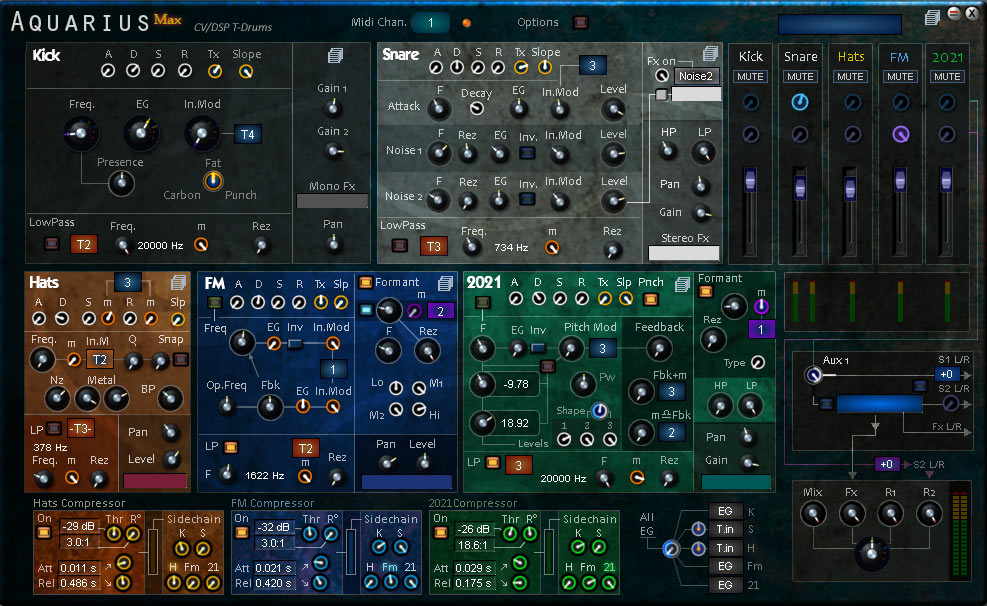

Aquarius Max (AquaMax)
- Adds the metal hats from Retro 5 to Aquarius
- Adds crossfadable VCO shapes from Retro 5 to Aquarius VCO 21
- this adds 8 oscillators so a diffrent device was thought necessary.

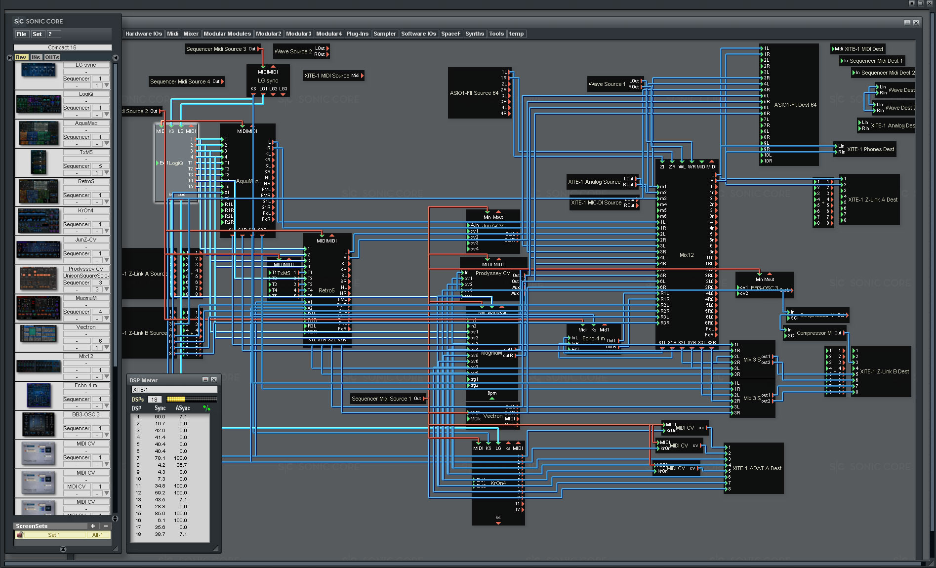

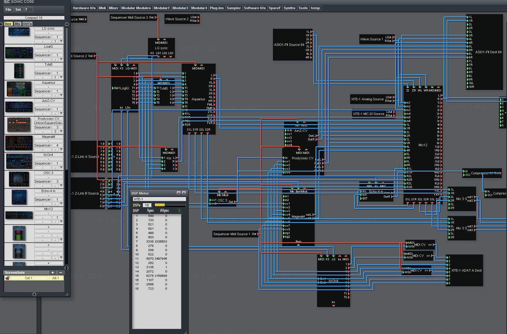

My default project in Xite

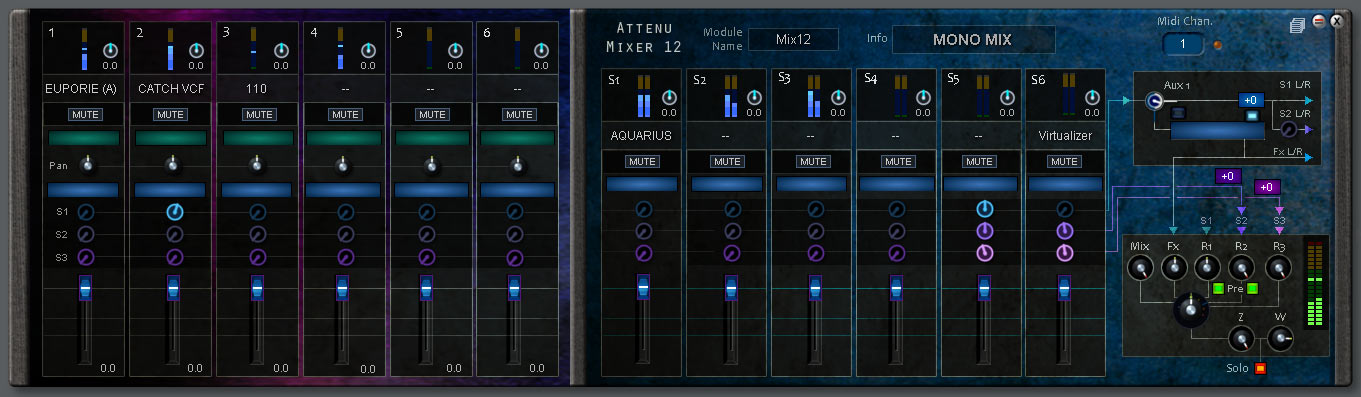

I could not leave you without Mix 12 (AttenuMixer12), the device I have designed especially for live mixes with Aquarius and KrOn + external mono synths or eurorack outputs: especially because of the "solo" button of the Z and W channels (it mutes all the rest = easy way to mute KrOn and Drumboxes as well as aux returns that are "pre" faders).
So, it is a small mixer for live purposes. 6 mono+6 stereo channels, and that's it (you can use two in chain though, ort even in parallel, by using the Mix3S below).
There is a very limited amount of insert Fx. The aux is rather extensive though.
Also, the fader levels are attenuators and there is no gain. There is a pre-gain though (from -6 to +12dB). If you need more than that it simply means that your levels are wrong somewhere (or lack a good preamp if it is microphones and guitars).
The faders are also used as on/off for live mixing; as there is no gain boost, you can confidently play them between 0 and Max and never fear to saturate the outputs.
No solo channel (only the solo button of W & Z channels - which is in fact used to mute the mix in order to make a pause on youtube, or phone call, or whatever).
It is the same aux section as Aqaurius/Retro5 mixer (but with 3 aux sends).
You will also find "Mix 3S" which has no surface controls and which is used only to merge aux sends from various sources (ie, i can merge aux sends from Aquarius/Retro5 and Mix12). Not sure it is useful for other puprose than a live session wiuth KrOn and Aquarius, which is the only reason why this mixer was needed...
Then, once you recorded your tracks, you would just load a project with your favorite mixer.

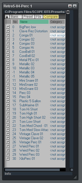

also, some useable presets for Retro 5-Perc 1 (spacef-devices.com download area)

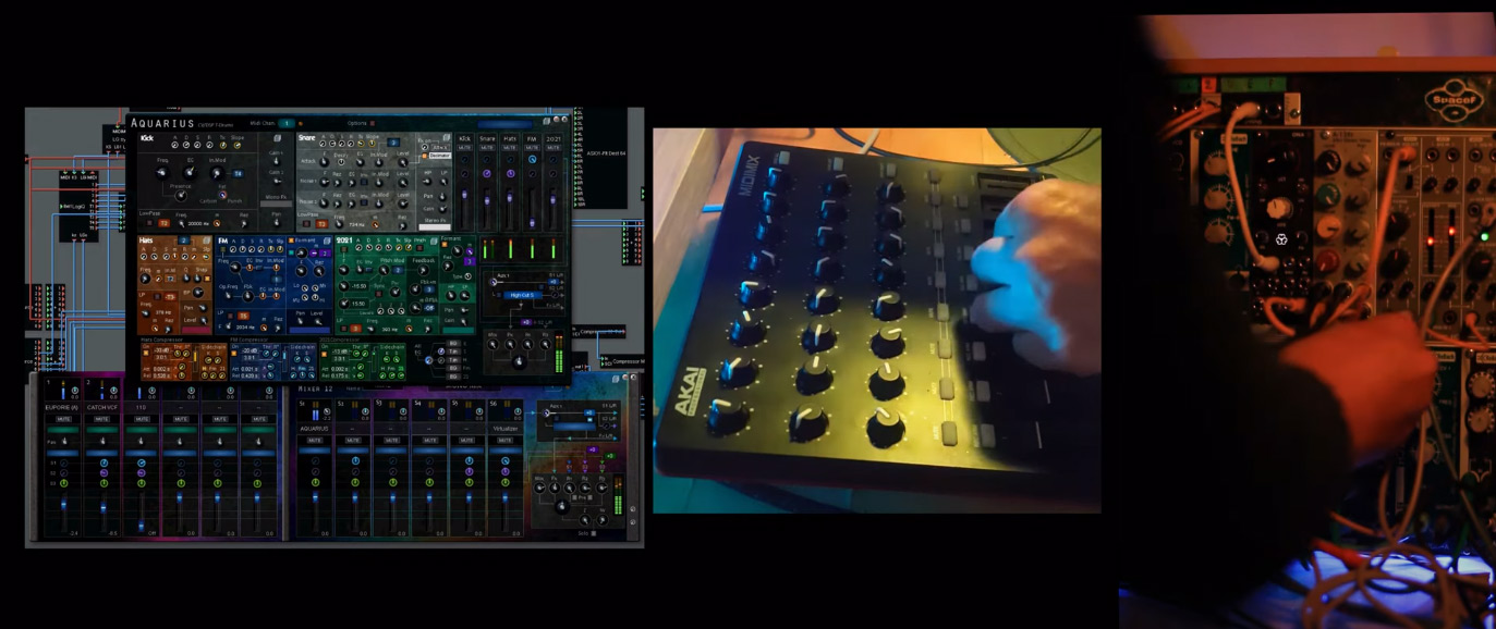

The latest versions in action. If you have a dual-monitor setup, you should be able to see everything in almost 1:1 size (the vid size is 3840*2160).
--> https://www.youtube.com/watch?v=5gTY1U9kMNk
Please note that the akai midi mix is really cool but the buttons work only in ableton live (in plain midi they are only "temporary" or "note-on", but it is not possible to assign them to mutes of a mixer (doh!).
They can send notes-on though, so I use them to trigger drums when editing. But here the midi notes are off (you can see me pushing buttons but no sounds because midi notes are filtered out to avoid "drumming by mistake" !). the size of the potis is fine, it's just the colors that makes it difficult to know which column it is (i will probably do a layout just for this drum box).
Enjoy!
