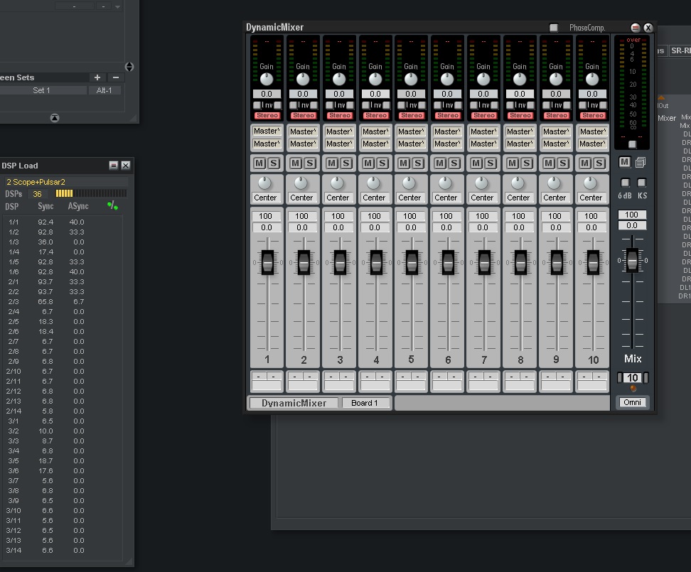

just did what you asked me ... and I think is crazy enough.. Please let me know if this is correct :
I loadded a dynamicMixer and set 10 stereo channels and inserted 20 MV's on the insert slots.... so far no pci problem .. I'm attaching an image, pls letme know if you see something wrong.

again ..another test done. Same old empty project with Dinamyc Mixer , this time I selected the board , on this case as you can see on the image Attached I selected the board 1 , wich is the Pulsar 2 , is the only card with 6 processors , on the Async you can se what dsp's are being used , and the total dsp usage .
Garyb already stated the MV-only test is enough to determine if the extender causes problems ( thanks garyb! )... but Let me know your thougths about this.
I think this proves the extender is a real good / working option , for users who need to expand their pic slots.

Hi snoopy4ever,
thanks for going through the lengths to test this - i know i hadn't been going easy on you.. but this indeed confirms the throughput of the PCI extender. that's excellent news!! 8)

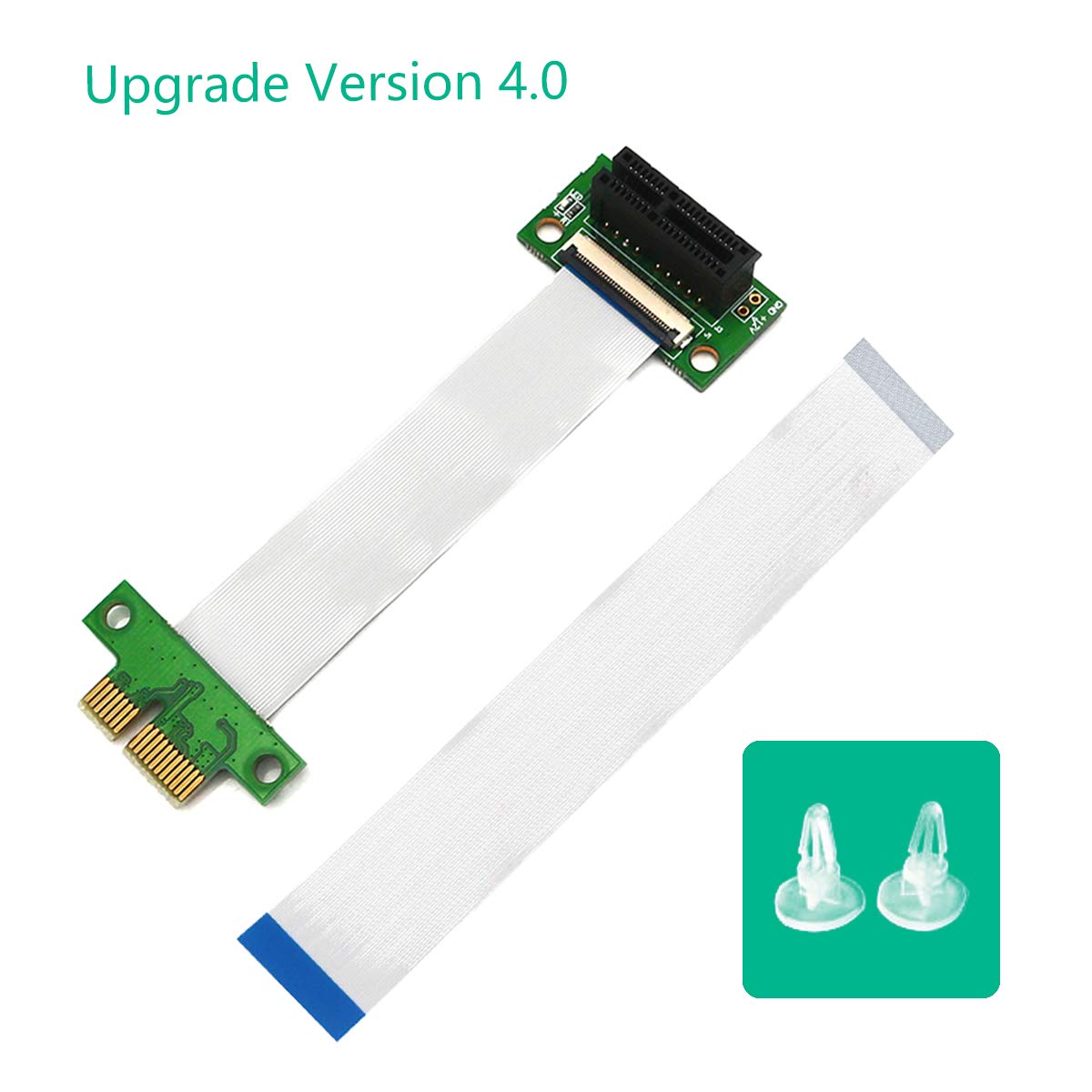

Hello Atom ... pls pls... I want to help as much as I can , pls check the port that you are connecting this card , on my case that port was completely blocked by the graphics card . Therefore I had to buy this :
https://www.amazon.com/gp/product/B017Q ... UTF8&psc=1
that is an extender for the port itself and beleive me it saved my life.
other than that I don't think you need anything els ( if that's the case ). But pls let me know if you have any doubt or question

i have a gigabyte x58 ud4 with actually very poor masterverb loading capabilities.
if the latency is good, i may give it a try.
i see the extender sells on amazon at about 40€, it could be a nice toy to try!
problem is how to fit the scope cards in the case...
thanks!
i found https://www.aliexpress.com/item/PCI-E-E ... 89018.html for 20€ incl shipping, doesn't mention a brand, but it looks exactly the same (incl the controller) apart from the "PCE2PCI N01 VER 002" on this one, the one snoopy4ever shows "N05 VER 02". I'm betting on it. The extension cable is at https://www.aliexpress.com/item/32857626033.html for 3€.
Edit, again, since i had posted wrong url: even cheaper, https://www.aliexpress.com/item/32849431927.html and exact same "N05 VER 02"
