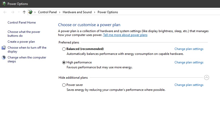

Re: Cracks and Pops - which line filter ?
I found a post on a Reason or UAD forum that spoke of WiFi causing interference in recording setups, and says the High performance setting stopped the Wifi interference. I tried it - as Ive had this issue for ages now - a little less since buyed the line filter - but still there - and low and behold - I have had crackle free sessions since I tweaked this yesterday !!!!! WTF ? WTF ? Who would have thought of this ???? DOH ! But its WORKING !!!! woohooo

spacef
Posts: 3356
Post by spacef »
Thanks JoPo, for some reason I was in "normal usage".... i've set it up to high perf...seems ok but too soon to say...
not sure why it was in "normal mode"....
there is nothing special about performance mode. it merely disables much of the power saving functions that can be turned off by "changing plan settings".

Well, heres the article :
https://uadforum.com/support-troublesho ... g2019.html
"Is seems that the wifi chip sends other polar patters while not beeing in high performance mode".

whatever. if it works, that's great. sounds like a wifi adapter problem...
I would think patters = patterns - and beeing = being :)
Terms like 'polar patterns' I've seen in the microphone manual as the direction the mic picks up sound from. e.g. there's a switch on my mic power box where I can select the pick up 'patters' :)
What the hell a WiFi device is doing sending Polar Patterns I dunno. But if the fix works, it works I guess - Ill take it even if by coincidence.
Sounds more like the device goes into a lower power mode and lags in responding to system requests for i/o. Most of these modern Wifi/ether/etc chipsets are PIO mode, like USB, which means that they are dumb IC's and driven by a software stack on your CPU. In 'high performance' mode they are always ready & processing data, so the stream is consistent and the interrupt handling is handed off fine. Intel chipsets are still coprocessed for LAN & Wifi, fwiw (and Bluetooth).
