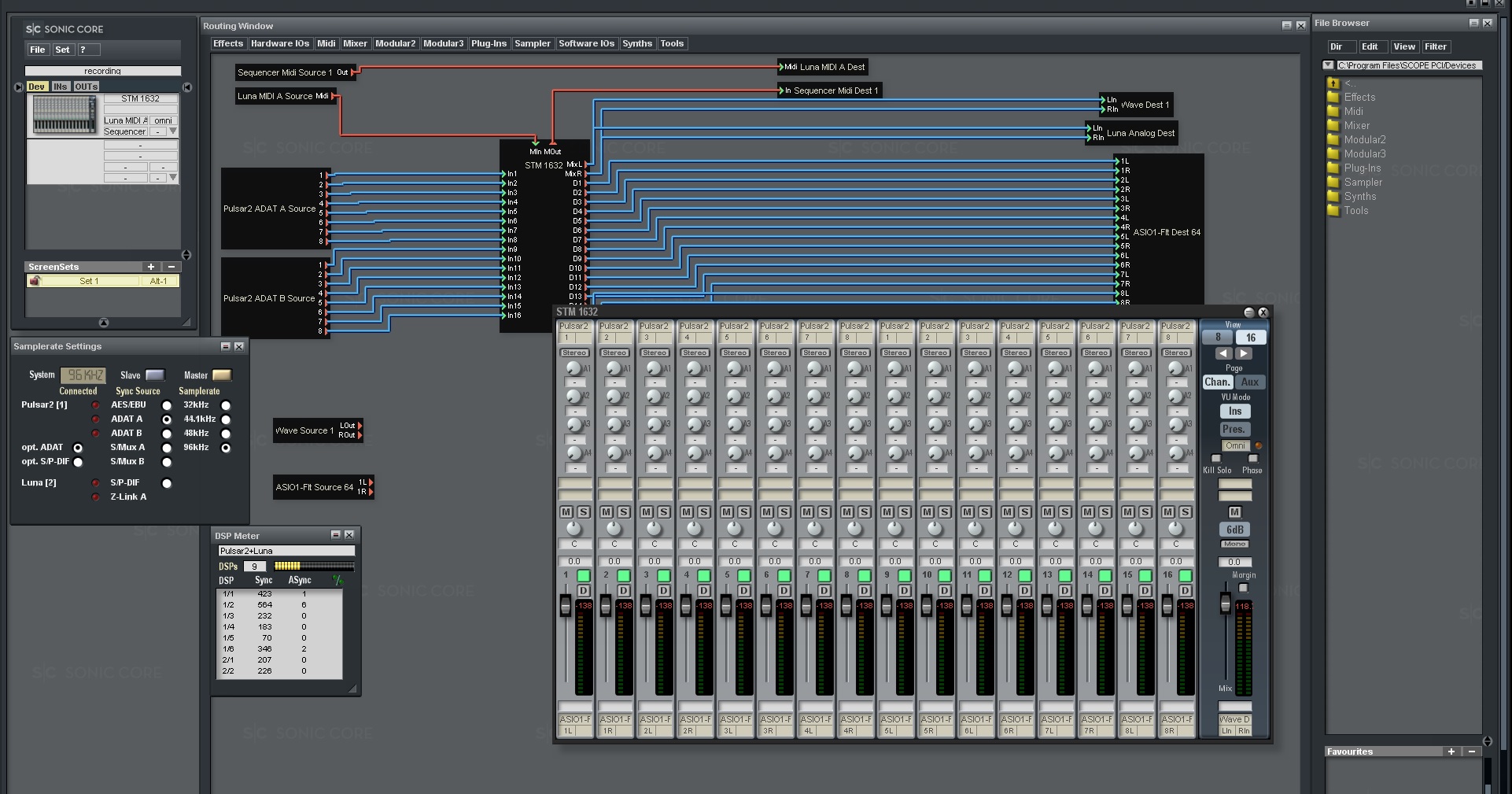

Can you put a Printscreen of your Sampe Rate Menu?
and... yes, the A16 may be faulty!

green led on the a16 master and 96khz
- screenshot.jpg (498.34 KiB) Viewed 5499 times

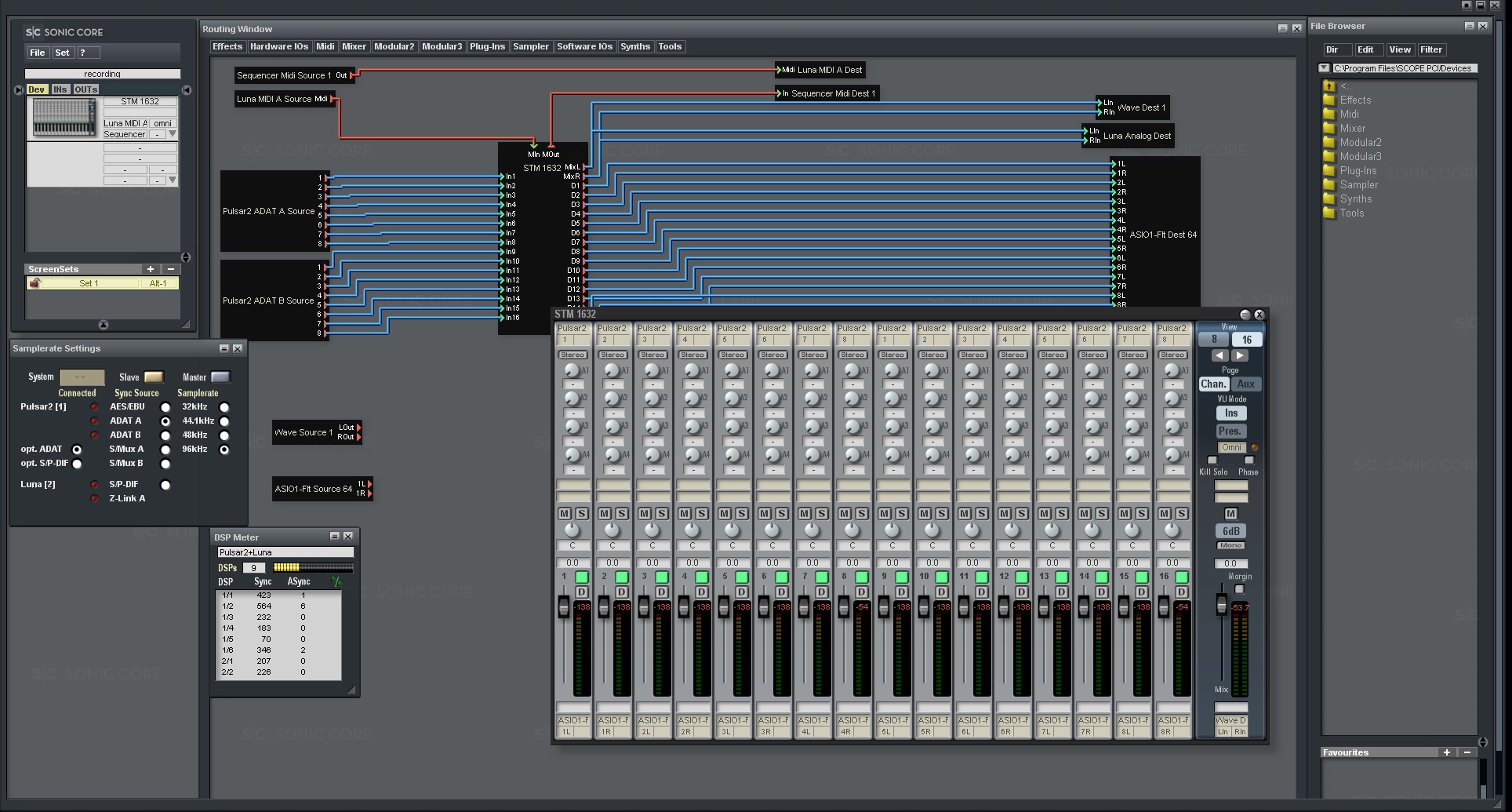

red led on the adat selection of the a16
- screenshot 2.jpg (490.2 KiB) Viewed 5494 times
Re: No signal in scope and daw
Have you tried through Z-Link? Just to check the Clock.
