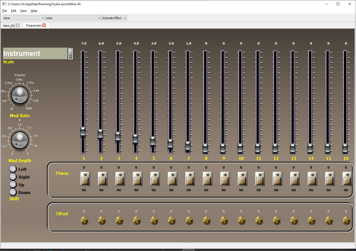

In the newest GUI (not published yet), I've integrated Knobman-Style knobs.Image

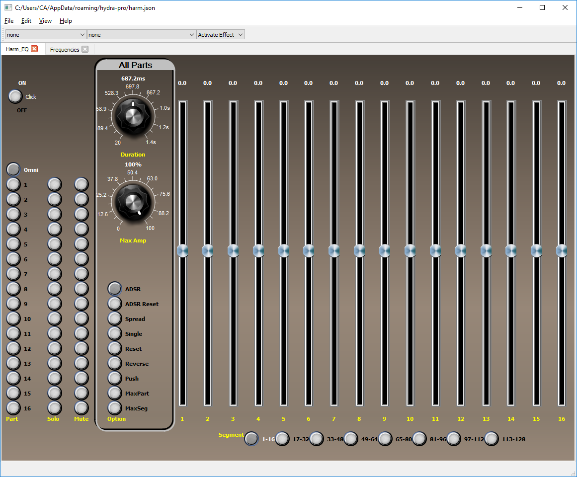

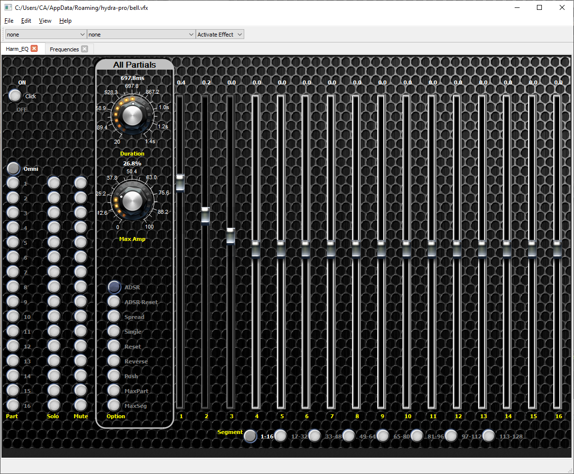

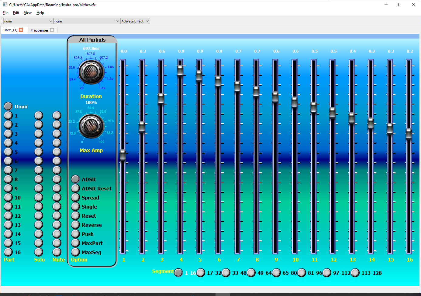

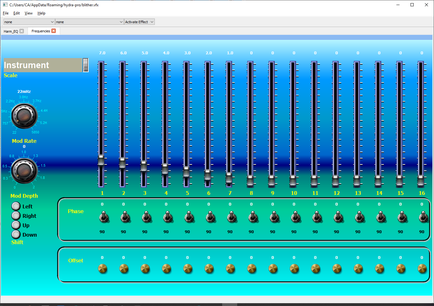

I added a theme (skin) facility. The user has a choice from standard ones or create his/her own. All knobs/slider heads are jknobman compatible (stitched images) and backgrounds/slider heads etc are just pngs. Some examples:

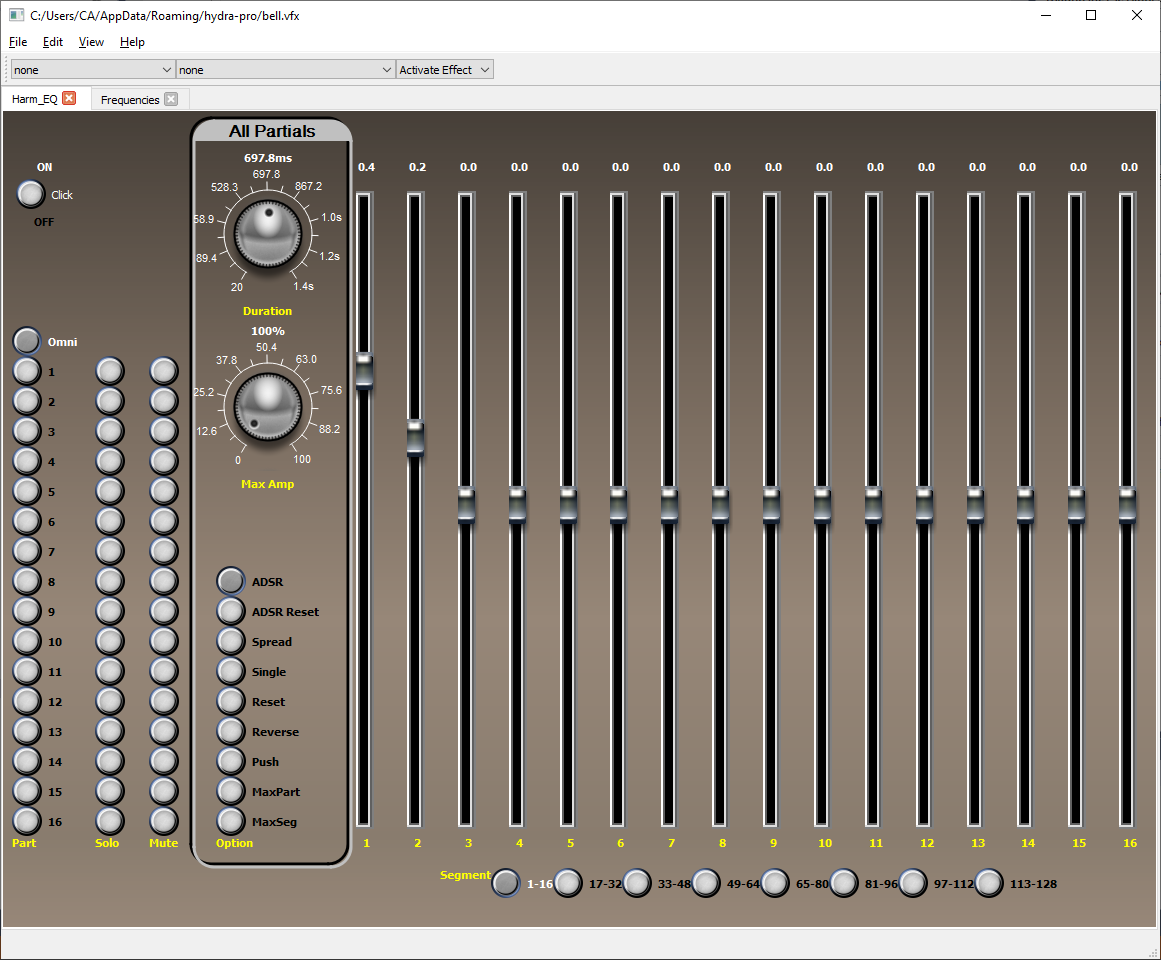

Posts: 7701
Re: New Sound Designer Tool : Harm Gen Synth (non-Scope)
It's the channels I would change. If you can use the existing graphics and simply have them blend a bit more with the images you're using in the background while keeping the depth of the channel black, I think it would look better.

DragonSF
Posts: 406
Post by DragonSF »
I see what you mean. I changed the theme according your advice. What do you think?
