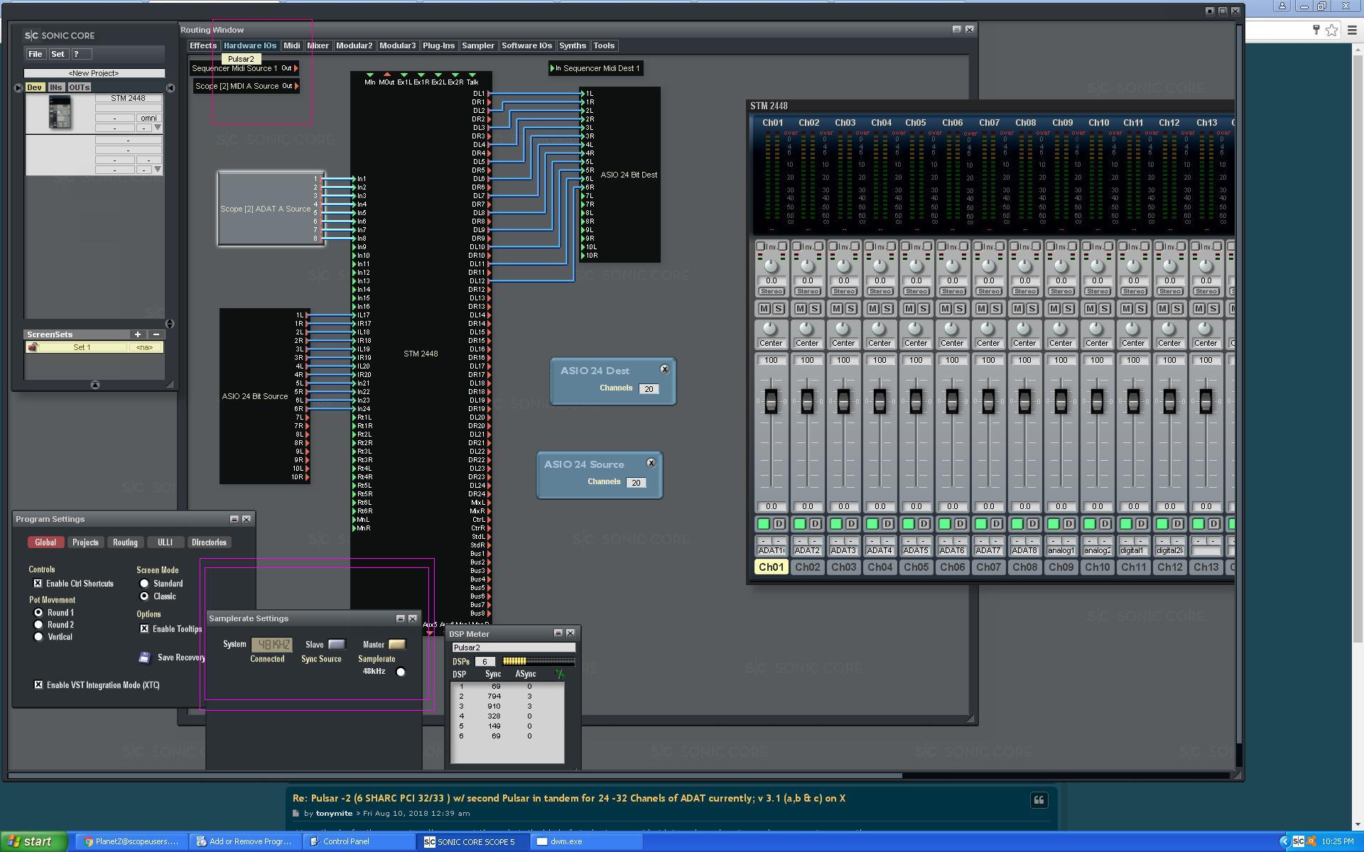

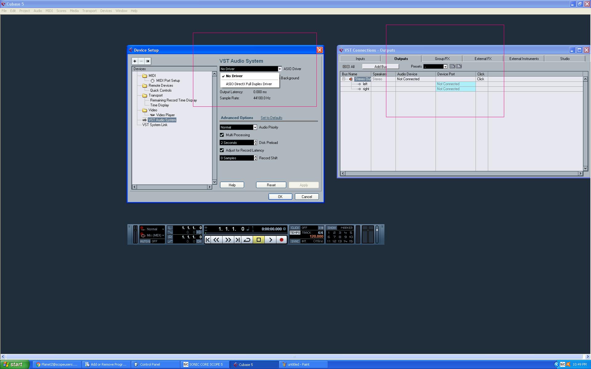

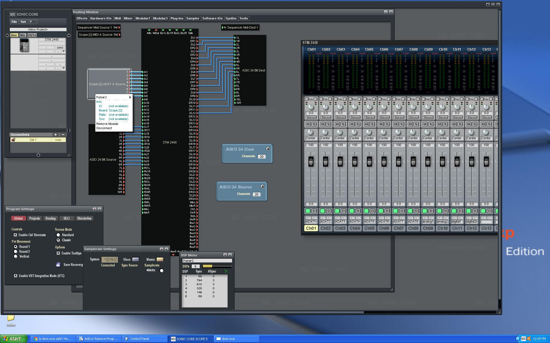

Hi guys,
I'm still stuck - as you can see via attached screenshot;
1) - Besides Adat port not receiving audio via Adat lightpipe from Adat HD24XR, (I've tried both Adat ports)
2) Sample Rate options do not appear except 48kHz,
3) I/O: Not Available (Incl Pulsar 2 Hardware I/O)
Any Ideas?
Any Help is Help - Thanks in advance.
Any Ideas?
				- No VST Driver.JPG (170.25 KiB) Viewed 7078 times
				- Pulsar 2 Hardware I-O.JPG (298.06 KiB) Viewed 7078 times
				- No Sample Rate Options.JPG (287.05 KiB) Viewed 7078 times
Re: Pulsar -2 (6 SHARC PCI 32/33 ) w/ second Pulsar in tandem for 24 -32 Chanels of ADAT currently; v 3.1 (a,b & c) on X
Have you already tried to remove the card, reseat the io board and put it back in place on the pc?
It must have the io plate recognized and working, otherwise there is a good chance that there is a hardware fault.
IMHE I would say ditch the Steinberg generic ASIO driver, disable or uninstall in Control Panel. Seat your cards. Reboot and check Control Panel for Scope PCI Drivers. If there, configure in Control Panel. If not reinstall Scope. You might also try VoiceMeeter and see if it recognizes the Scope Drivers after you do the above.

there are no special tricks. if you have a matching pair of ASIO modules in the routing window before opening Cubase, and if the Scope drivers are shown in the Device Manager of Windows, then Cubase MUST see it.

I will try with Reaper which is showing something - but not actually working at this stage & I'll isolate incoming Adat banks of 8 and whether signal is actually coming in. Also try a playback.
Plan B) Try it in 32 bit mode using Pulsar Scope 3.1c (I had v4.5 somewhere but can't find it & don't see it available on Scope Portal).
If that fails then I'd say the card is redundantly faulty :-/
