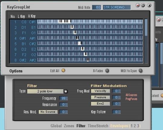

Yesterday I used ReLoad with RePack to extract all from Best Services Peter Siedlaczek Advanced Orchestra. This took 6 minutes to create a Reason NN-XT ready to use refill. Then I did the extraction for Scope detailed here http://www.hitfoundry.com/issue_09/sts_mast.htm under converting AKAI samplers and loaded STR SORDINO into both an STS5000 and an NN-XT which are both playable from a Reason project using the External MIDI Instrument in Reason to trigger the STS5000 running in Scope.
Cant hear any difference whatsoever so far. So - the filters you're referring to in STS - are they the ones in Keygroup=>Options=>Filter ?
Once I work that out, I can do a comparion on the STS filter vs NN-XT filter. The NN-XT filters both at the program level and the sample level. Then I can conduct tests across a wider range of samples.

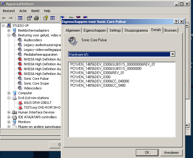

But...i am probably the only one still on XP (pci cards) haha...only for sdk 4
I just switch the drivers, disable and re-enable cards by script (so no restart required) and run the other software versions.
Lines for my script are: (just a simple .bat file)
devcon disable *VEN_14B5
devcon enable *VEN_14B5
couldnt get the devcon to exchange the drivers though
But in the near future i will go on to win7 probably, if it was only to use the remaining 8gb of ram :lol:

Posted: Tue Dec 05, 2017 1:18 pm
by RA
@Music Manic
btw, did you try and manually point your device manager to the driver folder from the v7 folder. (because of the "driver not properly installed" message)
i get this when i try starting v51 or 7 when i still have the v4 driver installed or vice versa
As it says, driver not installed...reinstall driver from the version you want to run. (excuse me if you already tried this)

RA wrote:@Music Manic
Yes did that first. I'm also PCI on XP.
I just uninstalled the cards and rebooted. The restart loaded v5 drivers then I went to SCOPE PCI/DRIVERS/ and ran the v7.exe to update the drivers to version 7 nad it now asks me to trust Sonic Core (which it didn't before). Rebooted and still same error.
After I installed SDK too and it tells me Windows cannot verify drivers Code 52. Does it have anything to with C++ install?
Thanks for help btw.

Posted: Tue Dec 05, 2017 2:22 pm
by RA
If i point the device manager manually to the driver (because i dont have an exe for the driver....just inf) there is no trust etc issue here.
Sp3 is needed
And if you use the script you don;t need to restart xp...but you need to make sure the pointers are right (VEN_14B5)

Posted: Tue Dec 05, 2017 2:33 pm
by Music Manic
RA wrote:If i point the device manager manually to the driver (because i dont have an exe for the driver....just inf) there is no trust etc issue here.
Sp3 is needed
Ah I'm still on Service Pack 1. Is that it? I get drivers in ok but when I reboot device manager General tab says:
Windows cannot verify digital signature for the drivers...................Code 52
