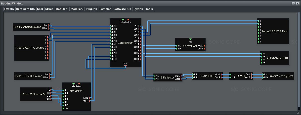

also, we cannot see which ASIO dest module you are using. the ASIO source and dest modules much match and both must be present.
Previous to this issue only the Asio source was in place (and during the re-installation/testmode activation), simply due to the rerason that I need (on this PC) only the play out path. Base on your recent post I added the Destination as well but it didn't help.

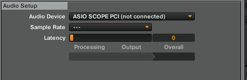

It's onyl a DJ Software called tractor pro by Native Instruments...
						- Unbenannt1.JPG (16.87 KiB) Viewed 7161 times

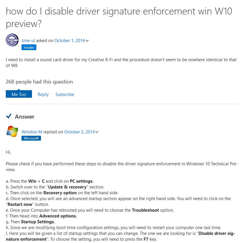

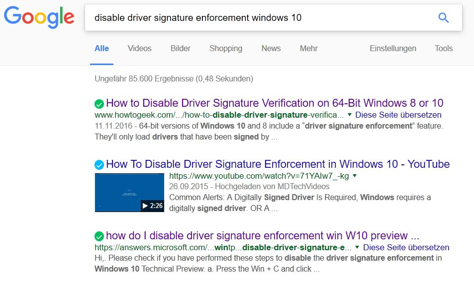

				Hi Victor, not sure which "GaryB tip from the Microsoft website" you refer to. Assume it is...
						- Unbenannt1.JPG (98.54 KiB) Viewed 7137 times
Refering to....
						- Unbenannt.JPG (102.12 KiB) Viewed 7137 times
Tried that way as well without any change. It does not work. Just to make clear, installation executed without any fault and the scope application worked after re-installation. The only problem is the Asio issue.

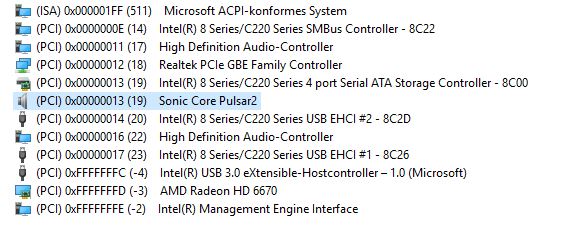

				Posted: Sun Dec 11, 2016 11:21 am
				that's Live that doesn't work, correct?
no, i don't know where to start. what is sharing an IRQ with the card?
that's very strange that ASIO worked in the past with only a source module. it shouldn't...
				Re: Win 10 - scope driver does not work since recent update
				Posted: Sun Dec 11, 2016 11:33 am
				by mcm060769
				No Gary, it is Tractor Scratch, a DJ audio application. Asio shouldn't work in the past....agree, interesting.
Here is the screen dump that might answer your question....
						- Unbenannt.JPG (48.96 KiB) Viewed 7101 times
				Posted: Sun Dec 11, 2016 11:47 am
				oh...
i don't know how well Tractor works with Scope. i'm pretty sure someone has used it.
the IRQ sharing looks ok.

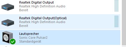

				I guess used the wrong terms. I meant the wave driver.

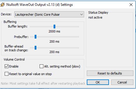

For example if If try to set Sonic Core Loudspeaker as standard I can do this but sound is coming still from the previous selected output (Realtec on board sound).
						- Unbenanntselect.JPG (17.45 KiB) Viewed 7072 times

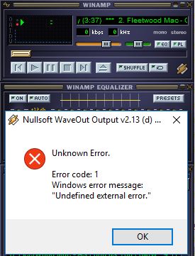

Using the winamp preferences dialog -> Nullsoft WaveOut configuration  the sonic core loudspeaker appears in the device selection dialog.
						- Unbenanntoptsonic.JPG (33.39 KiB) Viewed 7072 times
.....but as soon as I select the scope driver I get the following after pressing play:
						- Unbenannt2.JPG (32.39 KiB) Viewed 7072 times
Regarding Asio4all I'll come back in the following post...

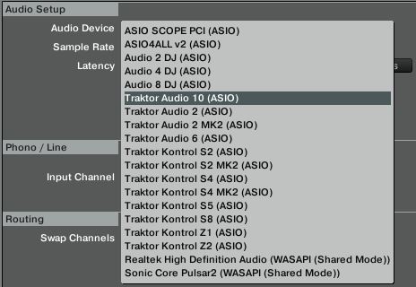

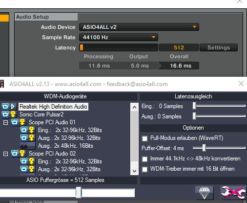

				After installing Asio4All this appeared in the tractor:
						- Unbenannttrac.JPG (37.77 KiB) Viewed 7072 times

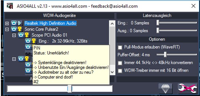

After selecting ASIO4ALL v2 I get the following...
						- Unbenannt.JPG (46.03 KiB) Viewed 7072 times
No failure from Tractor any longer. As you can see, Realtect and Pulsar appear in the list. Same behaviour...Realtec works and pulsar not.
The scope application still works wonderfull but to exchange sound between windows apps and scope app/card doesn't. Neither via wave nor Asio.
Btw in case put the mouse over the yellow symbol I get the following help text:
						- Unbenannt5.JPG (58.01 KiB) Viewed 7072 times
Any suggestion ?
