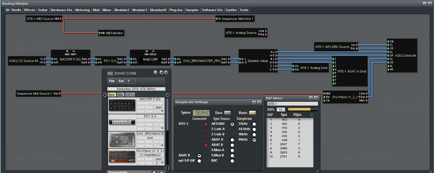

Yesterday I did a little experiment to see if my XITE-1 was worth keeping as a sound module on another computer running at 96 khz, though for my test I left it connected to my main computer. I couldn't even get ProWave running at all. All that I had running was a MIDI in, ProWave and an ASIO output module (2 channel). I tried assigning it to specific DSPs, but no luck there. I could not get it to show up to Live as an ASIO device unless I ran it at 48 khz. What could I be doing wrong if you're getting 4 voices out of it (and some mastering plug ins) on a 1D and I can't get one voice of it running alone on my system? Could it be because I'm running Scope on a 64 bit system?

Correct, wave/sample player components do not work on 64-bit (for the most part).

zerocrossing wrote:Yesterday I did a little experiment to see if my XITE-1 was worth keeping as a sound module on another computer running at 96 khz, though for my test I left it connected to my main computer. I couldn't even get ProWave running at all. All that I had running was a MIDI in, ProWave and an ASIO output module (2 channel). I tried assigning it to specific DSPs, but no luck there. I could not get it to show up to Live as an ASIO device unless I ran it at 48 khz. What could I be doing wrong if you're getting 4 voices out of it (and some mastering plug ins) on a 1D and I can't get one voice of it running alone on my system? Could it be because I'm running Scope on a 64 bit system?
Nothing to do with 64 bit - Im running Win8 64 bit here. Its probably down to the presets. I can only get 3 voice poly whilst using the standard issue MasterIT - but last year DAS released MasterIT Lite so when I need 4 voice poly on the proWave I substitute MasterIT Lite into the project.
Here are my presets, under the 'CC-Presets' bank theres a series of 'CC-PadAttack' presets that I use and get 4 voices out of.
