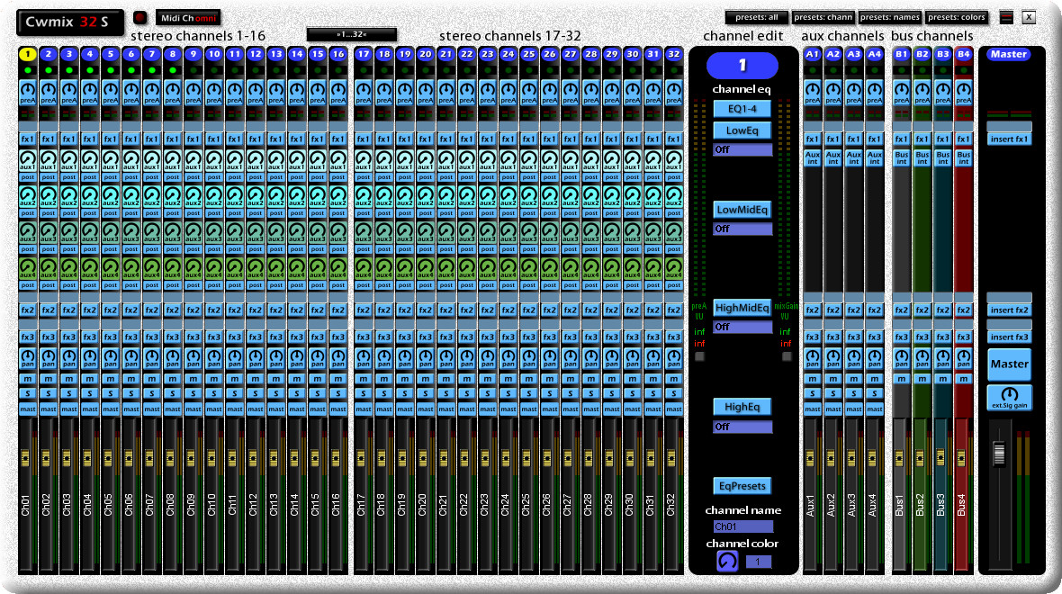

I just realized that Roy's Cwm32S mixer is what I'm looking for ! I can't explain how I forgot it.
I like a lot mute group feature and Cwm32S mixer doesn't have it.. But I can easily handle it with busses.
I like the 32ch view.
I gonna test it. :)

by JoPo
What a pity !
By building my project with Cwm32S mixer, I began to have cpu spikes by adding asio connected channels. Since it didn't happen to my system before, I tried the same project with the STM 4896 (I'm on Xite-1) and the cpu performances are much better : nomore spikes.
What happens ?
Is Cwm32S mixer using more computer ressource than STM ? How is it possible ? It's a pity because one reason I use Scope is because more computer ressource are left to the DAW, if Scope uses it, I don't have anymore for the DAW...
So -> back to STM...
I'd like a 32 stereo channels mixer + 4 stereo aux + some busses less heavy than STM4896 but which leaves my computer cpu as quiet as possible ! :D
If I understand well, the Cwm32S mixer, as it is now, allows Scope user to save Scope ressource, which is very good if needed.
But Roy, if you read this thread, would it possible to make (in not more than few minutes) a Cwm32S mixer which would leave the computer cpu alone ? After using it, I really like it and I'd like to keep it.
Thanks !
Re: BigMotherMixer MK2014
Posted: Wed Dec 31, 2014 3:30 pm
by Yogimeister
It seems like it really hogs graphics resources on my DAW ...
Do you have the same problems with the gui closed ?
Posted: Wed Dec 31, 2014 4:44 pm
by JoPo
!! Damn you're right !!
When I close the mixer gui, cpu ressource goes back at a normal level.
I never close the mixer gui, that's why I couldn't notice that.
Thanks, Yogi ! I'm going to use it finally ! Excellent ! I just have to close the mixer gui as often as possible.
But if it was possible to optimize the gui graphic ressource, it would be so nice..! :D
