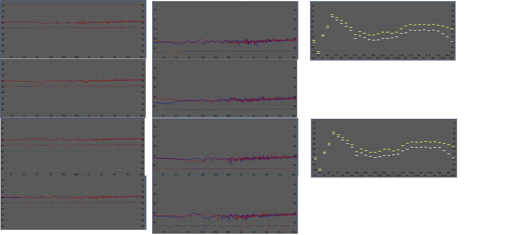

pics:
Up to Down: Dry, MultiFX, 2A, 660
Left to right: Mono noise to stereo output, Dual Mono noise (stereo), 1/16th loop of program material
Up to Down:   Dry, MultiFX, 2A, 660<br />Left to right:   Mono noise to stereo output, Dual Mono noise (stereo), 1/16th loop of program material
I dont see anything I can put my finger on - but I DO think I hear sonic differences as in the audio clips I posted above (Please listen to them with good headphones / monitors and notice the overall spectral depth/height and extreme lows and highs)

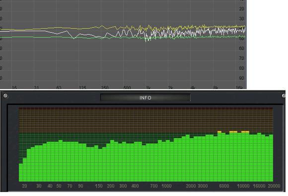

I ran White noise via HPM control pack and got this peculiar output .... (There is also a reference spectrum added)
Pure WHite.JPG (35.58 KiB) Viewed 2706 times

What are you trying to achieve with these noise tests? We use noise to check the acoustics of rooms.
Why you don't just try a phase cancellation test?
Also you should use tools that you know that they are working right.

fra77x wrote:What are you trying to achieve with these noise tests? We use noise to check the acoustics of rooms.
I used white noise (as was also suggested above) to check the spectral response of the devices.
I did a phase cancellation test and also posted the audio samples (see my audio files above) ... if you have any comments on these , please let me know ....
I also did a "Program material" spectral response comparison - 2 spctrographs on the right side of the posted jpg ...
My "Tool I know" is the one I used as reference ... I just had the ControlPak open on my SCope because I am checking it out and noticed this discrepancy ...

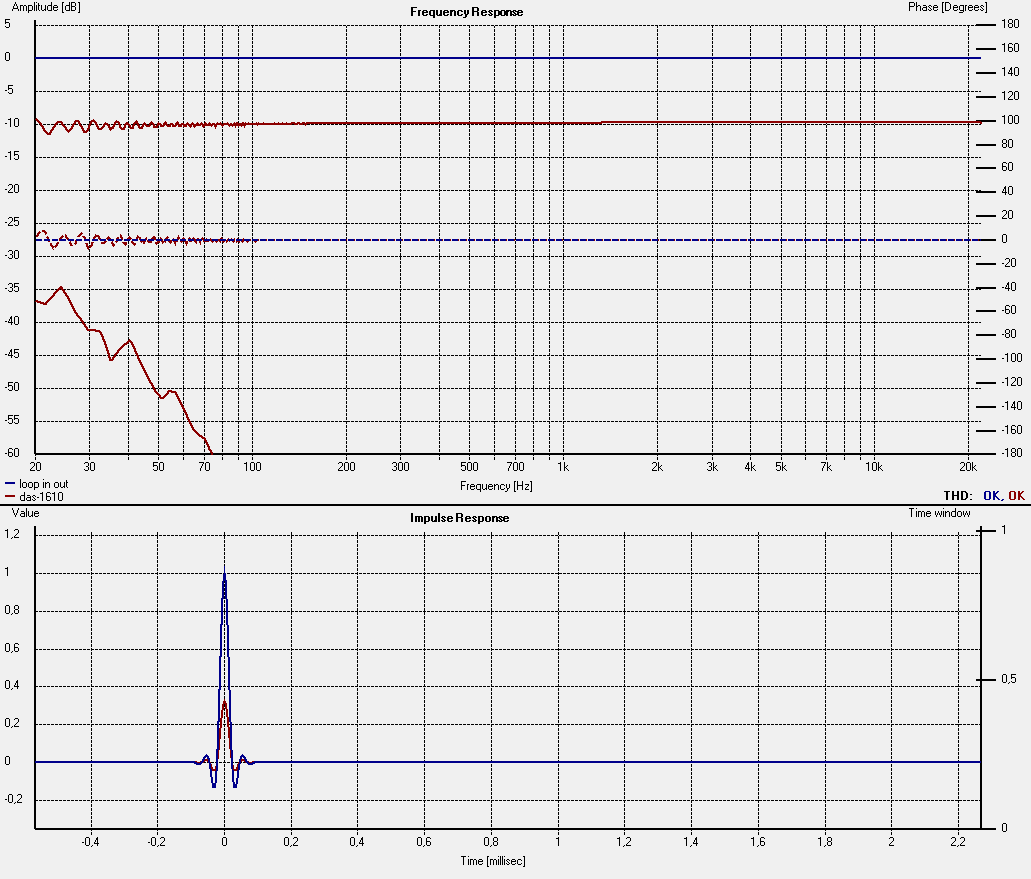

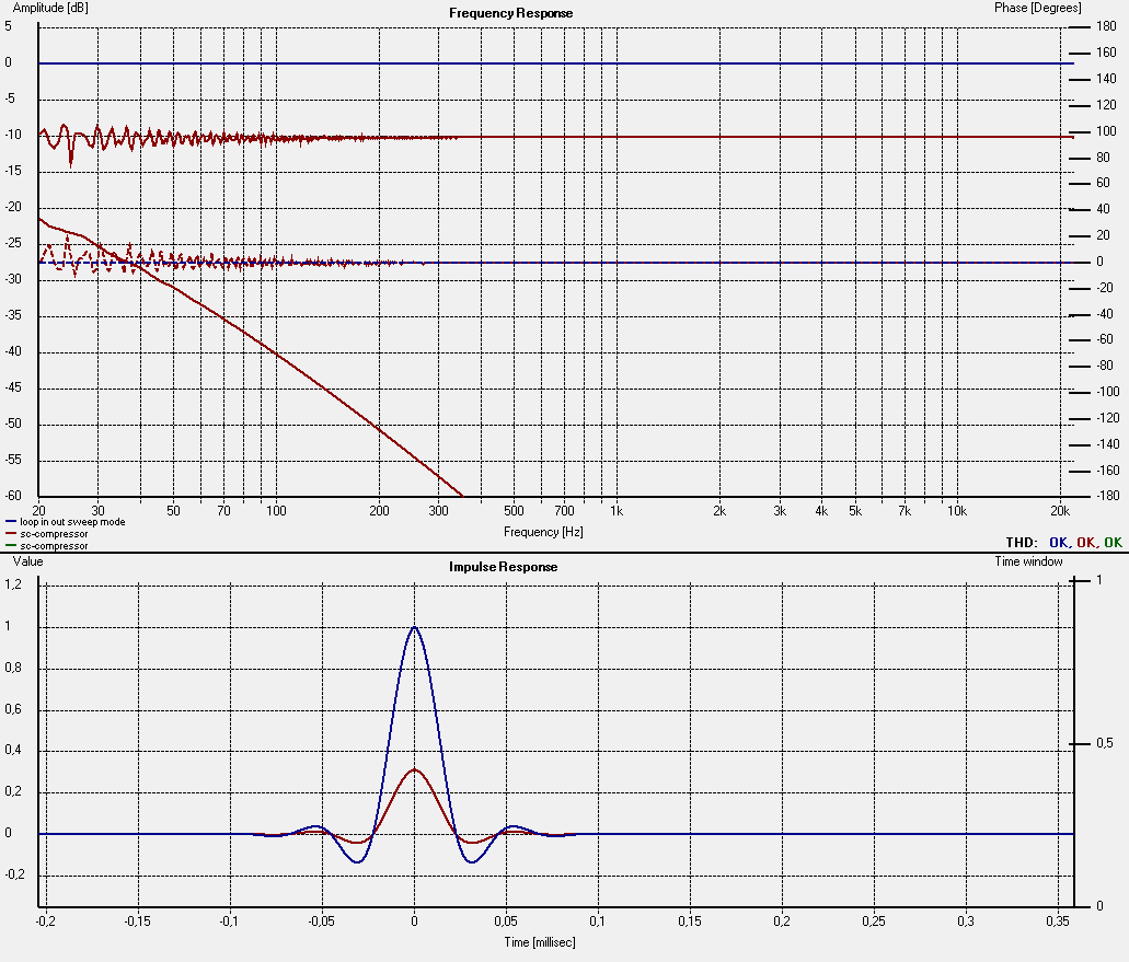

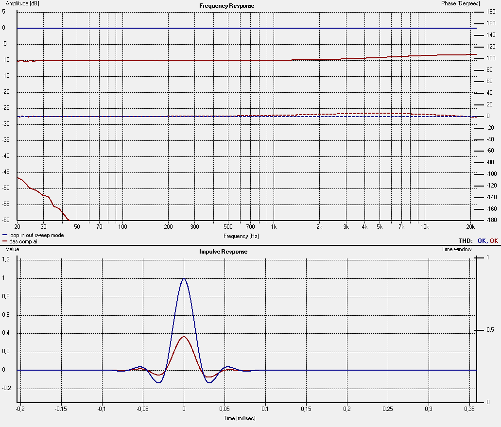

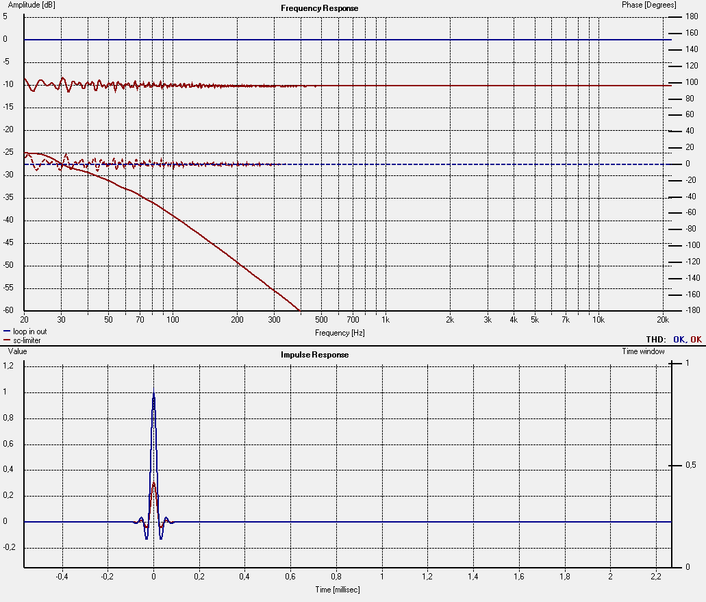

some tests.....
Re: DAS compressors and lowend stereo image / mid res
Posted: Fri Jul 18, 2014 9:55 am
Posted: Fri Jul 18, 2014 9:56 am
it all looks pretty normal.

Interesting Gary ... Not sure what to make of the THD curve (and why its only in the lows) - but it does seem like there are phase nonlinearities in the low end and a few spectral notches in that are to match (i am guessing that these could be more pronounced if there is a concentration of alot of lowend energy in a small band which has some of these nonlinearities (such as a tuned kick and single note bass) resulting in some cancellations (destructive interference) between neighboring bands that have been phase shifted (especially if - like in my case - all tracks (and thus lowend energy) is in phase originally ....) which could explain why i am noticing it more when phase compensation is turned on ....
One thing i didnt see is evidence of some sort of mid resonance (in wavelab i did notice some boost in the 200Hz area ... Will upload the pics soon ...)
Did you get a chance to listen to the audio i sent ?

I will post the spectrographs to help direct the listening - but again - sound like low and high end reduction/over-tightning (could be phase cancellation notches in the lows and resulting high artifacts) plus what seems to be a small boost around 200hz).
The bigger picture is that to my perception - the soundscape is "narrowed" from high and lows towards the mid - and sounds less "rich" ....
(Flick between the first and third (2A) where these differences are more pronounced ...)

Not very easy to notice - but there is a bit of attenuation around 50Hz and boosts around 200 and 500 in sections 3 and 4 (out of 5) especially ...
Which correlates to (- or subjectively influenced by) what I hear ....
