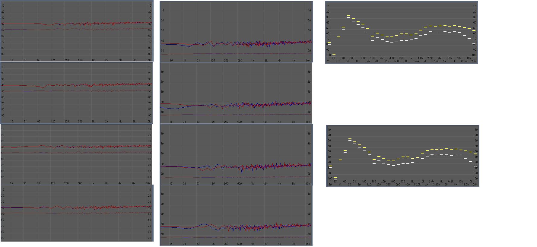

Secondly,
I ran some white noise tests (using the Modular NoiseOSC) (in mono setup and stereo setup)
pics:
Up to Down: Dry, MultiFX, 2A, 660
Left to right: Mono noise to stereo output, Dual Mono noise (stereo), 1/16th loop of program material
Up to Down:   Dry, MultiFX, 2A, 660<br />Left to right:   Mono noise to stereo output, Dual Mono noise (stereo), 1/16th loop of program material
I dont see anything I can put my finger on - but I DO think I hear sonic differences as in the audio clips I posted above (Please listen to them with good headphones / monitors and notice the overall spectral depth/height and extreme lows and highs)
For me, in front of the studio speakers - its as if energy is taken from the spectrum that hits your bottom throat and moves to the upper throat/lower nose area .... If you get what I mean ... ;)

What are you trying to achieve with these noise tests? We use noise to check the acoustics of rooms.
Why you don't just try a phase cancellation test?
Also you should use tools that you know that they are working right.
Yogimeister
Posts: 323
Joined: Sat Jan 12, 2008 10:12 am
Re: DAS compressors and lowend stereo image / mid res
Post by Yogimeister »
fra77x wrote:What are you trying to achieve with these noise tests? We use noise to check the acoustics of rooms.
I used white noise (as was also suggested above) to check the spectral response of the devices.
I did a phase cancellation test and also posted the audio samples (see my audio files above) ... if you have any comments on these , please let me know ....
I also did a "Program material" spectral response comparison - 2 spctrographs on the right side of the posted jpg ...
My "Tool I know" is the one I used as reference ... I just had the ControlPak open on my SCope because I am checking it out and noticed this discrepancy ...

I dont know what you set up in this pic (are you phasing the white noise with itself ??)
I dont have these devices/modules in scope pci ...
I am working on wavelab spectral analyses to upload (you can see slight differences but my screencapture is not working with it ...)
In any case - and most importantly - beyond the debates of ways to test spectral response and phase cancellations (i know a bit about waves and DSP) - please LISTEN to the examples I uploaded (through capable monitors/headphones) and tell me what you hear/think ...

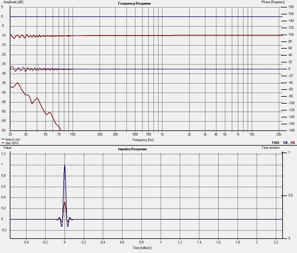

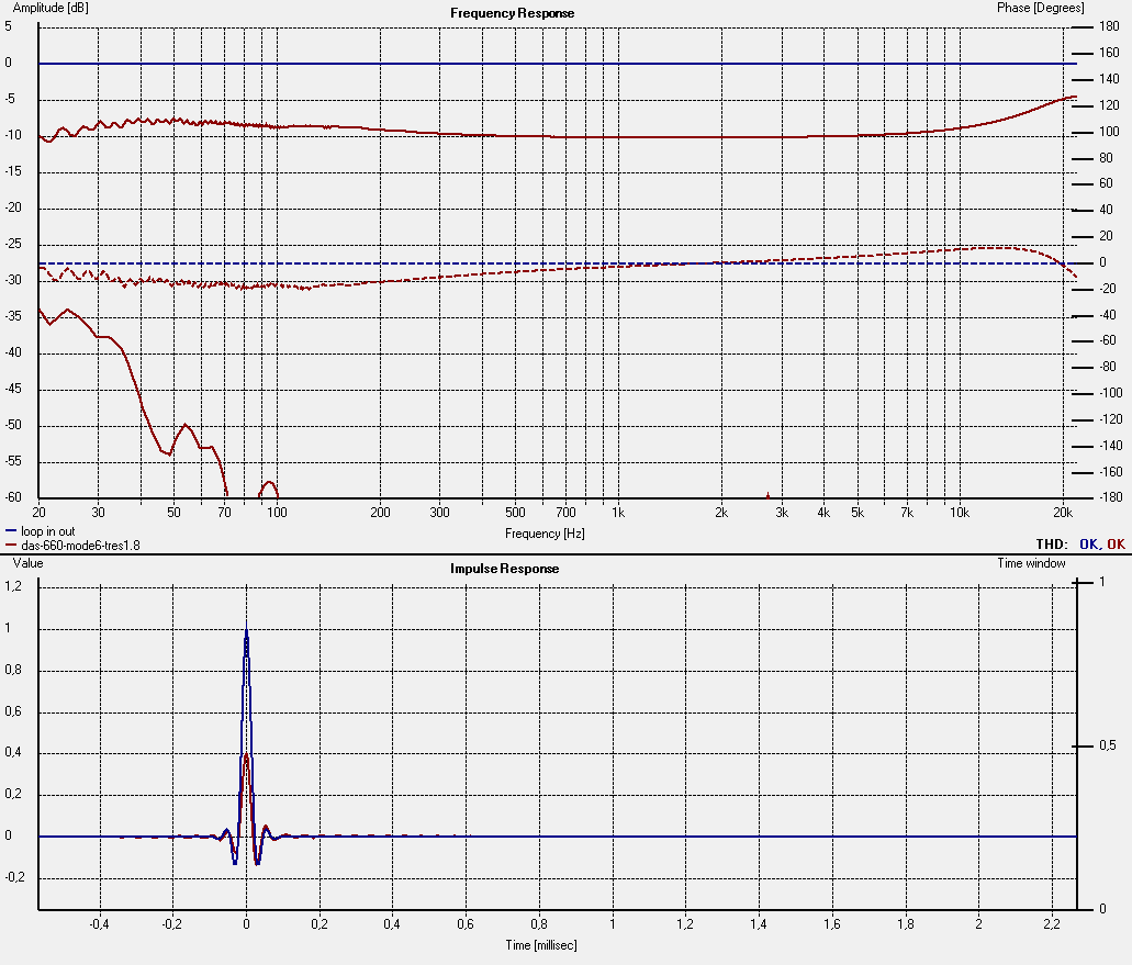

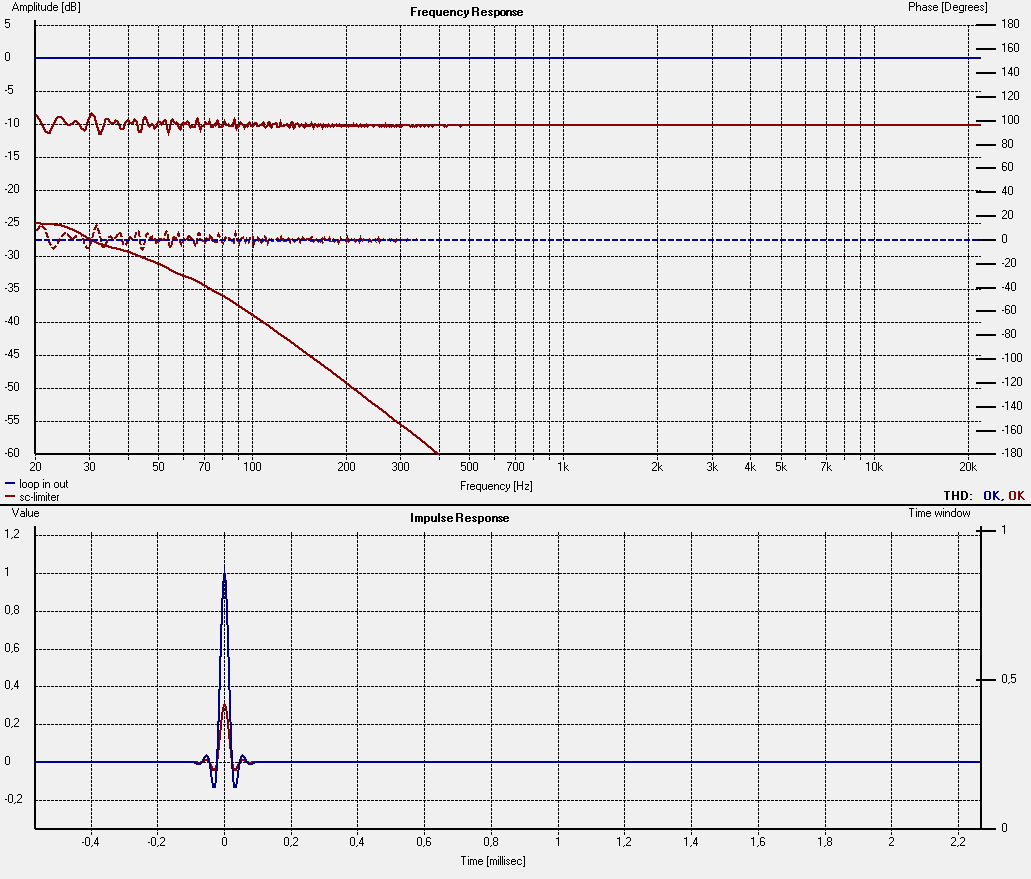

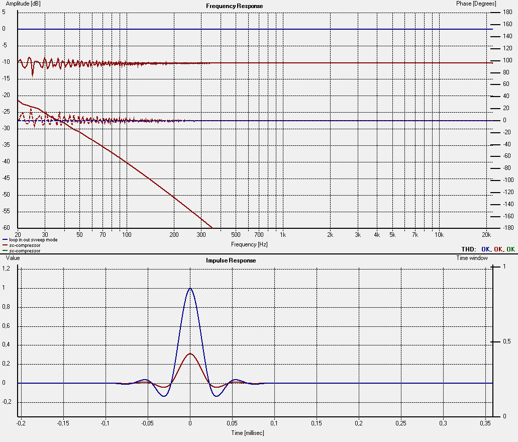

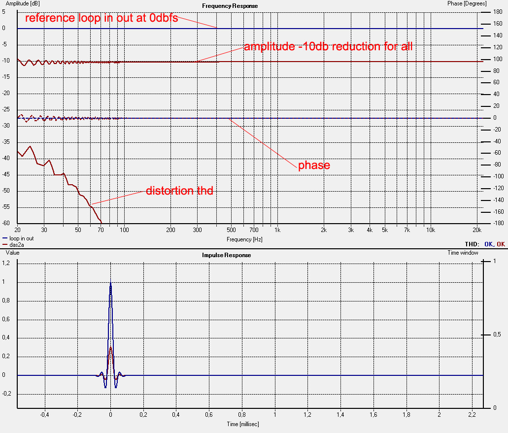

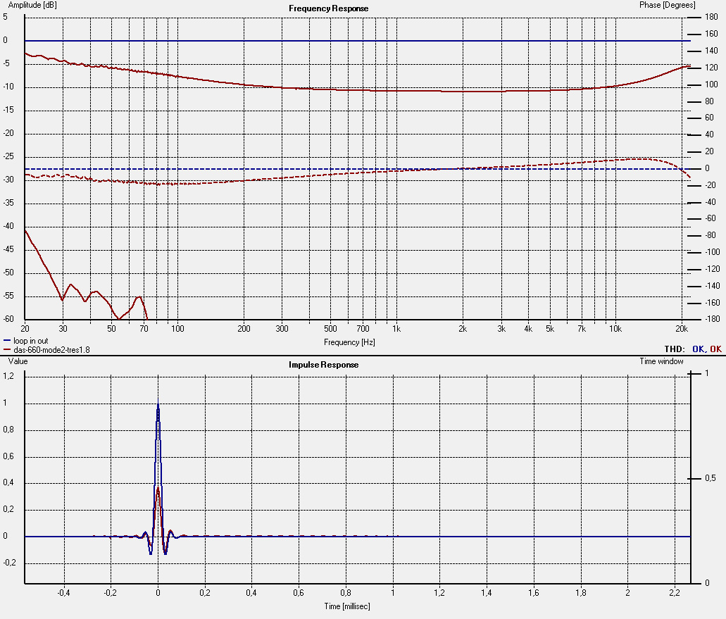

some tests.....
it all looks pretty normal.
Yogimeister
Posts: 323
Interesting Gary ... Not sure what to make of the THD curve (and why its only in the lows) - but it does seem like there are phase nonlinearities in the low end and a few spectral notches in that are to match (i am guessing that these could be more pronounced if there is a concentration of alot of lowend energy in a small band which has some of these nonlinearities (such as a tuned kick and single note bass) resulting in some cancellations (destructive interference) between neighboring bands that have been phase shifted (especially if - like in my case - all tracks (and thus lowend energy) is in phase originally ....) which could explain why i am noticing it more when phase compensation is turned on ....
One thing i didnt see is evidence of some sort of mid resonance (in wavelab i did notice some boost in the 200Hz area ... Will upload the pics soon ...)
no processor, ESPECIALLY a hardware one, is ever going to be 100% transparent. there's no reason to expect software to be any different, nor is that needed.
yes, i didn't hear any problem in your samples, but it's possible that i'm not listening to what you want me to listen to.
compression on the masterbus? optimaster, and various master limiters.
depending on the source material, it's very possible that you might see a boost in certain frequencies, with any compressor. a compressor works by making to loud sounds quieter and the quiet sounds louder....
