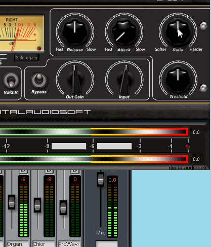

I think you are right, I forgot to turn of other devices before AI Comp in mastering chain. Now it behaves more conventionally. Tests this gif shows :
1) Both Ratio and Treshold at 12 o'clock. No Gain Reduction.
2) Turn up Ratio. Gain Reduction occurs.
3) Reduce STM output. Gain Reduction disappears.
Conclusion : There is an output level on the STM which will make your statement of just turning up Ratio without touching Treshold introduce Gain Reduction. This to me is an expected result - no surprise. The Ratio increase is simply responding to the 12 oClock threshold level in combination with your input level.
Posts: 5089
Re: DAS AI Electronik specs
Second test : Shows Treshold turning fully right (clockwised) increases Gain Reduction.
Conclusion: Treshold knob orientation seems to be the reverse of other compressors.

Heres the DAS1610++ doing the same thing - threshold and Ratio at 12oclock - no Gain Reduction. Turn Ratio up - Gain Reduction.
Captured with LiceCap http://www.cockos.com/licecap/

JoPo, here is test I made w/ DAS 1610 as an insert, turning Side Chain On and Off. No bluescreen here.
Is this the right test ?
