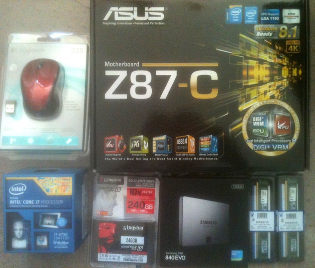

The i7 4790 came in and it was a bit cheaper than the 4770. A bit cheaper and a bit faster.
Heres the inventory so far (minus the rack casing) - next month, the build !

dante wrote:The i7 4790 came in and it was a bit cheaper than the 4770. A bit cheaper and a bit faster.
Dude you hijacked my thread! :o :lol:
Only joking good to see you got all your parts Dante. :thumbsup: What was the final cost on that if you don't mind me asking and did you have to ship in to AU? I'm looking at parts from the US to Melbourne at the moment. Most suppliers I've used in the past were Euro and may or may not ship out to AU although I did use quiet pc.com recently for a cpu fan (would definitely recommend them for low profile/quiet solutions) but would you recommend a good supplier in VIC?
Thank you all for the rest of the input. Coming round to the upgrade cycle again and realising now I know even less than I did last time I did this! Damn I need to stay current :x
Re: Intel board with i7 support and 3 pci slots looks good
Didn't add up the final cost, between 1 and 1.5 large. They did stuff up with the video card, fan obscuring one of the PCI slots. and the thing wouldn't boot without an F1 prompt. I took it back and they fixed it. Then I had an extra USB card slotted in and ended up disabling it ... Too many IRQ hassles.
I ripped out the MIDEX 8 as well to eliminate an USB usage, and use Scope card MIDI IO instead.
Nothing shipped in specially, just dealer stock at Airport West http://www.cnettech.com.au
They don't know much about DAWS much less DSP.
I will say one thing though, this beast is much quieter than the last one. Don't know if that's due to the SSD but my noise floor on Mic recordings is much improved. Whatever, that's good coz there's no chance of me getting the PC out of the room or isolated.
