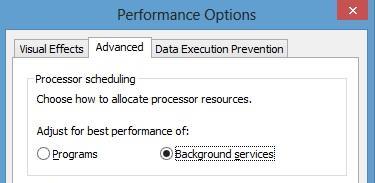

Posted: Thu Mar 06, 2014 5:05 pm
Did you do this re background services ?
- background processes
- background-processes.JPG (13.37 KiB) Viewed 2290 times
And what is ULLI set to ?
Re: pops and clicks xite -1d windows 7 64bit
Posted: Thu Mar 06, 2014 8:43 pm
by ShogunSpy
Thanks Dante. Yes I did and thanks for your webpage there's a lot of good info there.
