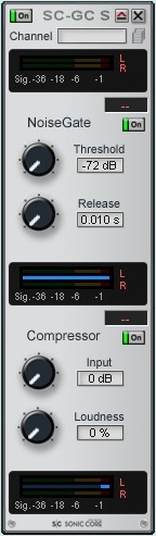

Yep, this is basically similar to an LA2A. The Input drives the Sidechain circuit to the VCA, affecting the Gain Reduction.
The Output is the Makeup Gain, boosting the overall signal leaving the device.
There isn't any Ratio setting here - but I imagine that the Input knob affects the Ratio as well the Threshold, and effectively the Release too.
DBX 'overeasy' is basically a soft-knee curve for the Ratio.. the higher the input gain, the more aggressive the ratio / gain reduction in and around the threshold. This effectively smooths out the Gain Reduction noticably kicking in. This could indeed be part of the algorithm they've implemented.
In my haste to describe what the term Loudness meant (as distinct to Makeup Gain on a compressor), and never having actually used this device, I thought what was marked Loudness was a separate control to the Output!! Silly me! :-)
I now see that there are just two controls... :-O
Hopefully that goes some way to explaining why I described it as a distinctly different control to what is normally labelled 'regular' makeup gain..
I do wish these compressors stuck to words for which there is an accepted global definition! I guess it comes from a time in the late-50's/60's when 1176's, LA2A's, Fairchilds, etc. all wished to market a defining set of terminology that differentiated 'their sound' and 'their response' and 'their colouration' from their competitors - i.e. the analog 'algorithm' of their tubes and solid-state components - when they all are basically implementing peak-compression curves...

Thanks again lads. Im also looking at the combo version of this device, where a gate is included as well. Im assuming signal flows from gate then to compressor.
What I'm thinking about there is the relative merits of whether to apply this affect at time of recording, or on mixdown.
For example, having a gate during recording might risk some parts of phrase attacks or bits of softer phrase getting cut out too late or early. So having the gate applied after recording allows for finer adjustment.
On the flip side, at record time, a well set device and predictable vocalist means the track goes down clean and well compressed with no need to muck around later.
Any experiences on this ?
